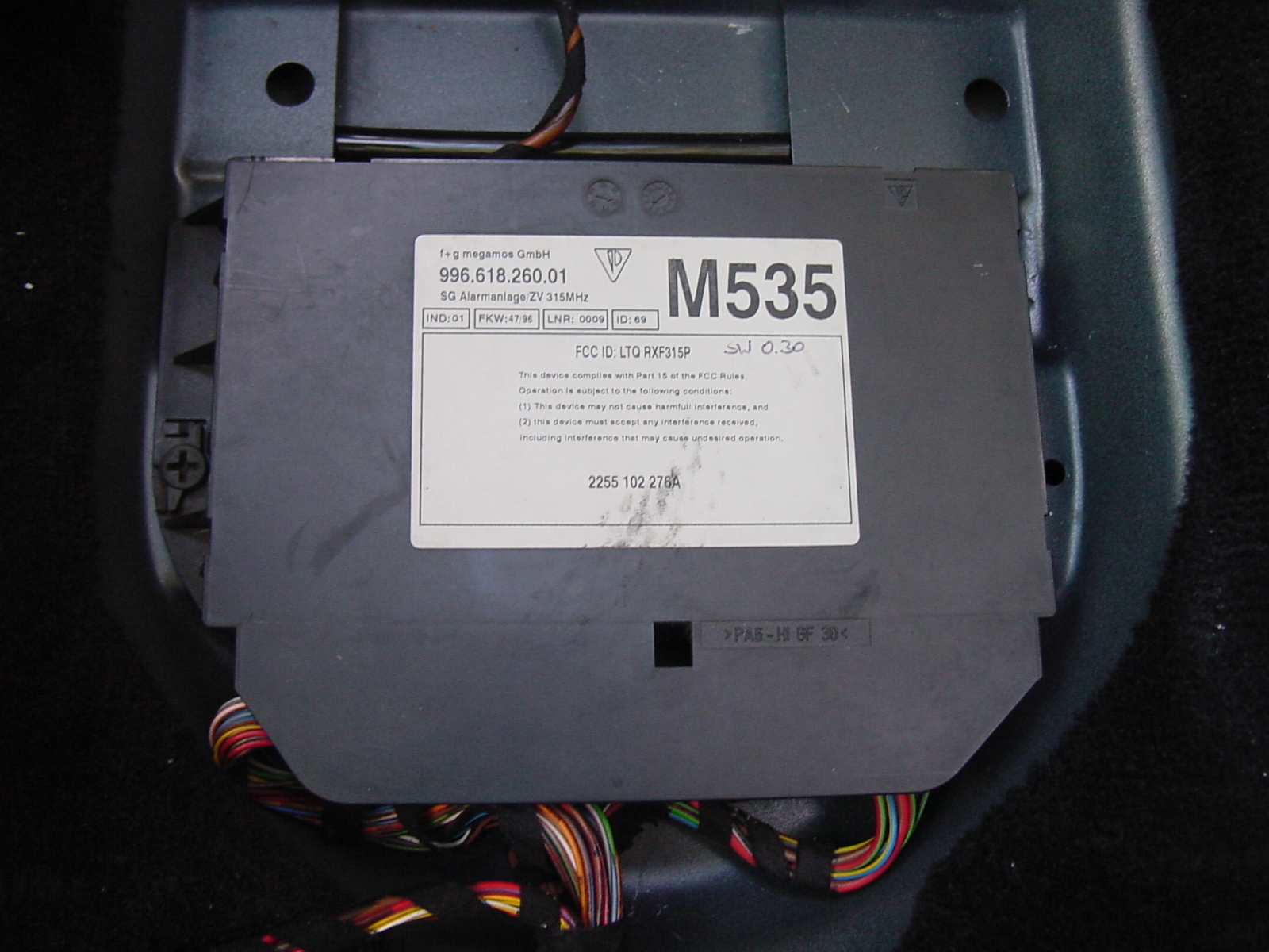

If your drain holes have become clogged, then it is very likely that you got water under the seats. In U.S. cars the central alarm control module is located under the driver's side (left side) seat, I believe it is located under the right side seat in U.K. cars.
Here is a photo of it:
As Beelzy says: get to it quick!
If it has just happened, you can remove the unit and open it up and then dry it with a hair dryer or heat gun. That might resurrect it if it hasn't started to corrode the connections.

I think his will say M534 - UK is 433 MHz.
And yes, it will be under the right hand seat on UK cars.

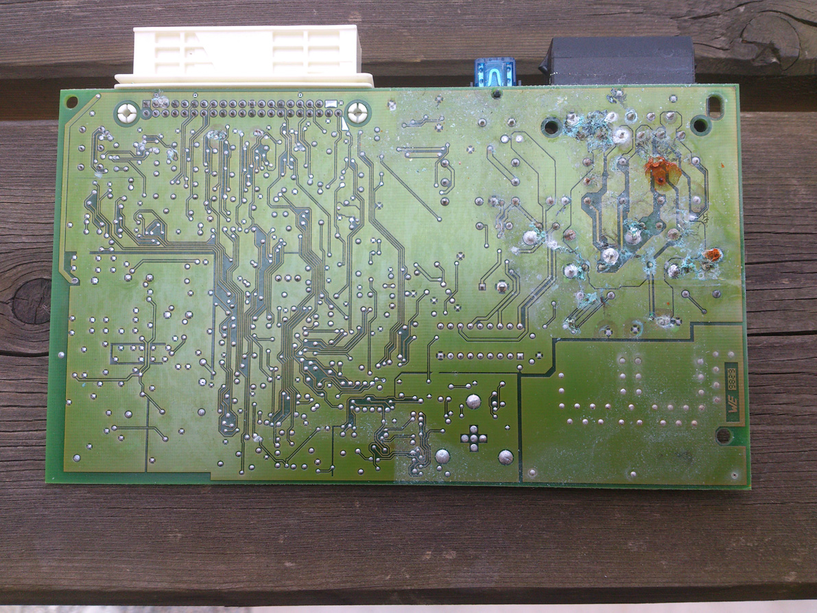

Hello all,
I've got the same problem but I realised perhaps too late that the control unit got wet. Since the picture was taken I have cleaned it with a tooth brush. Before removing it everything worked on the car apart from the central locking. What do you think - is it dead? Any tips on cleaning it further?
Henrik
