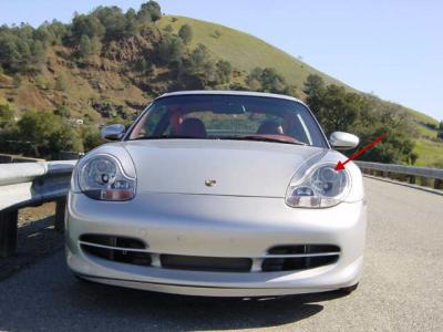

Litronics will have a lens (see image below). Halogen look like conventional headlights.

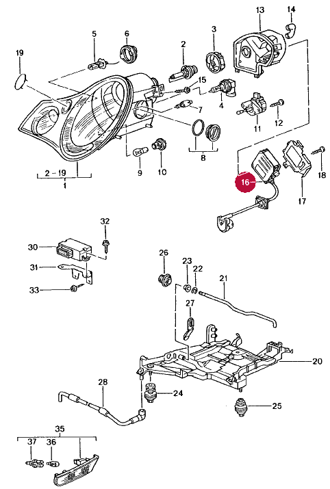

As I said my reply to your PM - -- Litronic and Bi-Xenon are different in how they work.
Your car is an 01 996TT and it has Bi_Xenon. That means one bulb and mask that controls what part of the beam is used for low beam vs. high beam.
The control unit on Bi-Xenon is attached to the headlight assembly (item 16).
