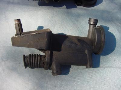

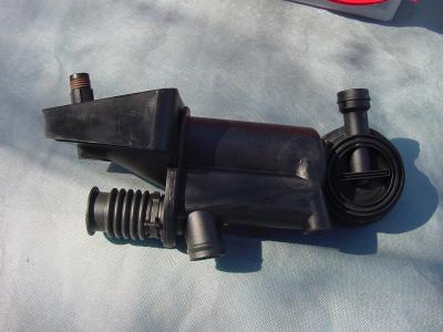

First of all, if you have the old style AOS (i.e., the top circular part is horizontal rather than vertical) then you should replace it anyway, IMHO.
Here are two photos to illustrate the difference:
OLD STYLE:
NEW STYLE:
If it fails completely, you run the risk of doing engine damage because the oil will migrate and cause something known as hydrolock.
