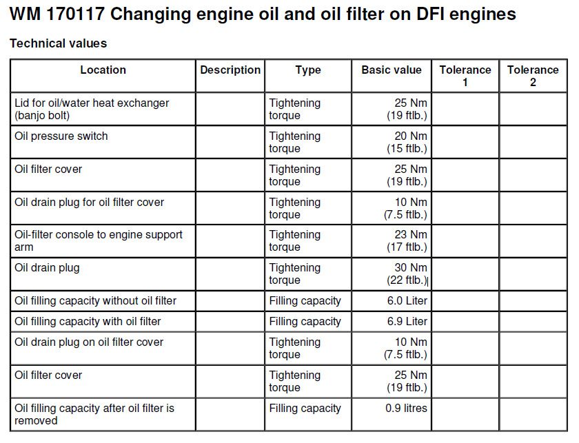

2 hours ago, Pxwguad said:
I'm, going to be doing my oil change this year on my 2010 Porsche Cayenne V6 and I was wondering if someone knows what the torque settings are for the oil pan drain plug, oil filter drain plug and oil filter cap is? Thanks in advance.
