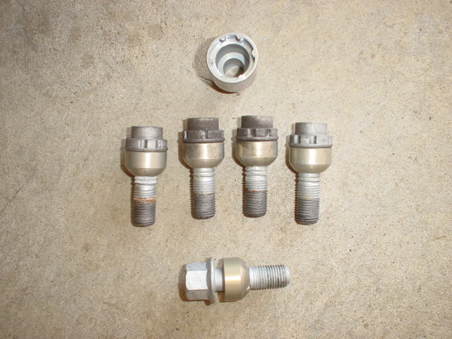

Bought 4 normal wheel bolts today at my dealer. Locking ones are off.
5 part numbers for wheel bolts - only Porsche.
They only had in stock the original version that came on my 1997. Too bad as I wanted to take pictures of all 5 versions side-by-side. Looking at the parts computer they almost doubled the prices from the original version.

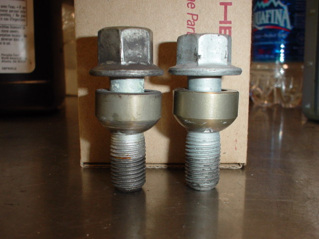

So almost a year later.
The new style bolt with the shorter head is ..... on the right.
