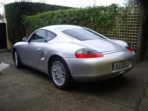

I've got a 2001 986 Boxster S - 32,800 mls (see profile photo with my Cayman Zeintop!). As any UK & Ireland members would have noticed, it's been pretty bloody cold the last week! The temperature has been as low as minus 6 locally the last few nights and I began to notice a very slight 'sticking' in the clutch yesterday evening.
