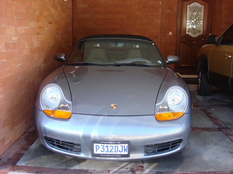

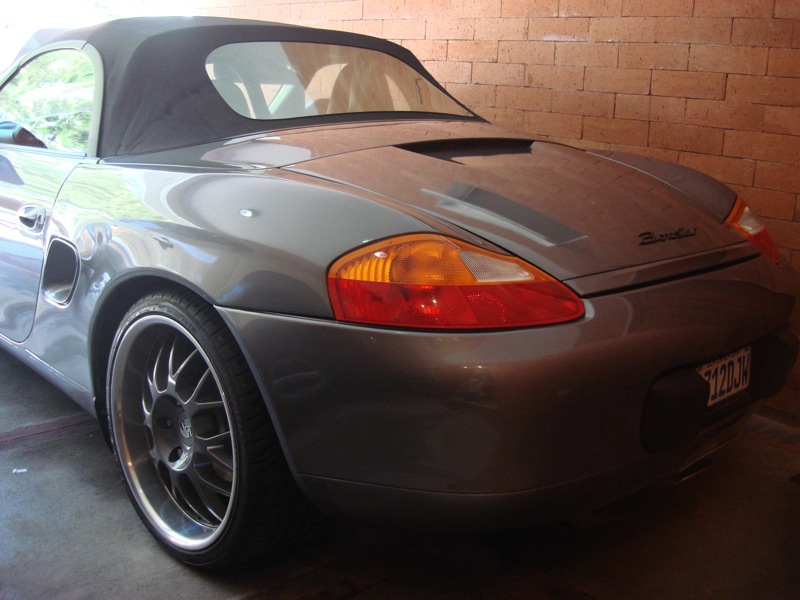

PD. I´m posting pictures of my car
Though most posts were about your wheels, if you look around, you can find a set of used cat bypass pipes fairly inexpensive. I bought mine from a forum member a couple years ago (Fabspeed), slightly used, but perfect condition for under $300 shipped. They are easy to install, sound very nice, especially in the mid range and provide a crisper throttle response. Whether there is a measurable HP increase or not, the seat of pants could not tell. My '02 S has the bypass pipes, a sport muffler (ala Pedro) and an Evo Hi-flow air intake. As mentioned earlier, throttle blip lag was almost completely eliminated by this setup. No CEL and emission problems for me...
