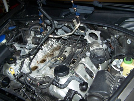

Sorry I don't have the pictures.. the wife accidently erased them when she used the camera last. Here is a brief write up. Hopefully this will give you an idea of whats involved. No special tools required.
1.Drain remaining coolant. Take the belly pan off and on the passenger side of the radiator (bottom) is a plastic drain plug (blue I think).
2.Take all the plastic around the perimeter of the engine off. (Lots of quick release plastic bolts)
3.Take the plastic engine covers off. I removed the secondary air injection units (black round things near the fire wall) from the bracket and just moved them aside without disconnecting them. This gave me enough room to get the plastic engine covers off. On the passenger side you have to remove the engine support ( 4 bolts that go into the head) in order to take the plastic cover off. Don’t worry the engine isn’t going any where.
4.Take the Y pipe off that goes to the throttle body. The 2 plastic bolts on the throttle body simple turn till you line them up to the key way then pull them straight up. Under the Y pipe is a hose that you have to disconnect so be careful when removing the Y pipe.
5.Undo the electrical connections to the throttle body and remove the various emission tubes that cross the intake. You squeeze the connection and pull straight off. I think there are two or three tubes.
6.Remove the throttle body… 4 bolts and it comes right off.

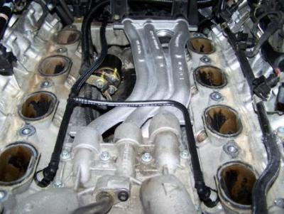

7.Remove the 4 bolts that hold the injector rail in place. You won’t be able to remove the injector rail until you loosen up the intake manifold and move it forward a bit. I simply pried up the injector rail with the fuel injectors left attached to the rail. Of course undo the electrical connections to the fuel injectors first!
8.Undo the bolts holding the intake manifold on. The bolts don’t come out they remain attached to the intake manifold. Once loose move the intake manifold up and forward to give you enough room to take the injector rail off and move it to one side. I used a piece of wire and hung it off the hood on the driver’s side.
9.At the back of the intake manifold are two vacuum connections. One is a hard pipe and the second is a rubber pipe. Undo these and the intake manifold will come right out.
10.Now you will see the 3 coolant pipes. They are held down by a plastic clamp at the back of the engine. I think there are 3 bolts you have to undo and there’s a wire harness that is also attach to the plastic bracket. Once removed you then can get at the hose clamps and slide those back to remove the rubber hoses from the plastic pipe. Then remove the 3 coolant pipes.
11.Now you have access to the large coolant pipe which is probably the one leaking. To remove this pipe you need to break it into two pieces. I guess this is why they use to remove the engine to get to this pipe in the early days. The new pipe comes in 2 pieces with a piece of rubber hose to connect the two. I used a large screw drive to break the pipe and then some tin snips and pliers to take out a large enough part of the center section of the pipe. (In order to not make a huge mess I broke the top of the pipe off and then sucked out as much coolant with a vacuum pump before completely breaking the pipe in two.) The pipe is very brittle so it will break away in large chunks. Then twist the pipe as you pull it – it will be very difficult, just take your time. Otherwise, it will snap off and leave a nice chunk lodged in the inlet of the engine. (I did this what a pain in the butt to get the remainder out). Do the same with the other half of the pipe.
12.Clean everything up. When putting the new aluminum pipes on I oiled up the o-rings so they would slide in to place a lot easier. It takes some force to get the pipes on and in place. Make sure you install the pipe that goes into the front of engine first with the rubber connection already on it and the hose clamps as well. When tightening up the hose clamps make sure the screw body on the clamps is nice and low otherwise it will interfere with the 3 coolant pipes above.
13.Now install the 3 coolant pipes and the new bracket that holds the pipes and reinstall everything else :)
Hope that helps! :)

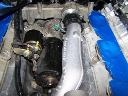

Craig,

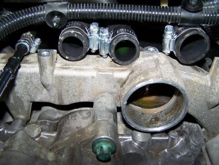

The metal part is the inner reinforcement of the old plastic tube, you have to remove the metal ring and the rest of the plastic tube. If you install the update light alloy tube, make sure that the starter can be removed later if necessarily, you can rotate the tube slightly on the rubber sleeve for perfect fitting and adjustment. Success.
Ray,

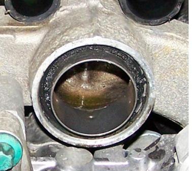

Can you tell me if I need to remove, what appears to be a piece of the end of the lower tube? Is this metal piece part of the plastic tube?
Thanks,
Craig
Yeap the end of the plastic tube broke off. You need to get that out of there. I used a small chisel and "cut " the metal ring so you can collapse it and pull it out. Then just break apart the the plastic. Be careful not to scratch up the housing or let any plastic bits fall in the hole.
Ray,
I ended up doing exactly what you said on the ends of the old lower pipe. I took a chisel and cut the top and collapsed the metal inner then removed the remaining plastic. To anyone who reads this:
Follow Rays 1-12 instructions and pay specific attention to the placement of the of the hose clamps so they don't interfere with anything that goes in after. Also, slide the rubber coupler and clamps on the lower pipe to the end and then back it over to where it should be after you line it up with the other end. You aslo need to install the "short" end first! Getting at the rear tubes is not easy!. There is a clamp that holds all three tubes together, that separates into two pieces (upper and lower). If I were to do it again I would remove the top piece of the clamp then squeeze the factrory installed hose clamps (to remove). Putting the upper tube back together, I tried installing the rear rubber tubes to the upper tubes first but I think I would have done them last. Make sure you grease up all ends of all the tubes with the appropriate lube. Definately hang the fuel rail off the hood with a wire hanger. The fuel rail rear screws can also be accessed after unbolting the manifold and moving it forward as Ray said. Then just slowly lift the fuel rail off of the manifold. The two screws or "PINS" that hold the throttle body and the y tube together are like and old-fashioned key. Turn the pin slightly so the key lines up in the holeand lift it out. I did not realize what Ray was talking about until I removed it. One of mine got damaged because it is a torx head and the pin is plastic so it stripped one of the heads. No big deal, I will replace that but the y tube can be held in place until then by any similar sized bolt. I am attaching the photos I took and you will notice I covered the valve openings with blue tape as a precaution. Good luck and I hope this helped.

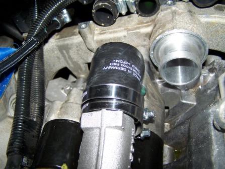

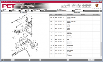

I just want to add one additional sparepart you should change out while you are at this job. Change out the cooling breather pipe with the part number 948 106 016 03, see part 20 in the attachment below . The price is just around 35$. This pipe and it's connections gets very brittle and cracks just for a good word, due to long service with hot fluid and hot environment. I experienced a leak on the test drive after installing all the parts.:angry:
One tip of getting the upper old pipes out is to saw them in two, drill a hole trough them, put a big screwdriver in the hole and jus bang the pipe out with a hammer.

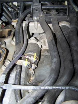

On lower bigger pipe, you have to be careful so you don't damage the knocking sensor and wires that is hidden under the pipe. I also experienced that the ends of the pipe got stuck left in both ends. :censored:
Safety
Also disconnect your battery ground connection, cause the starter still has power on it even if the ignition and key is out. If you i.e. get your watch between the + connection on the starter and the engine block, the watch may melt stuck to your wrist....... or at least blow some fuses and maybe damage the electrical systems on your car.
