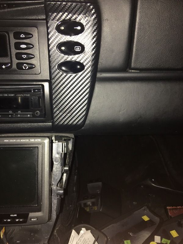

This was a Pain for me also. I ended up breaking it. I bought a aftermarket USB socket but didn't use it. I wrapped with CF vinyl and liked the look with it covered. Radio has a USB for charging. No need for a cigarette lighter. Sorry for the mess in the pics. I am in the middle of painting my middle console so things are apart right now.
