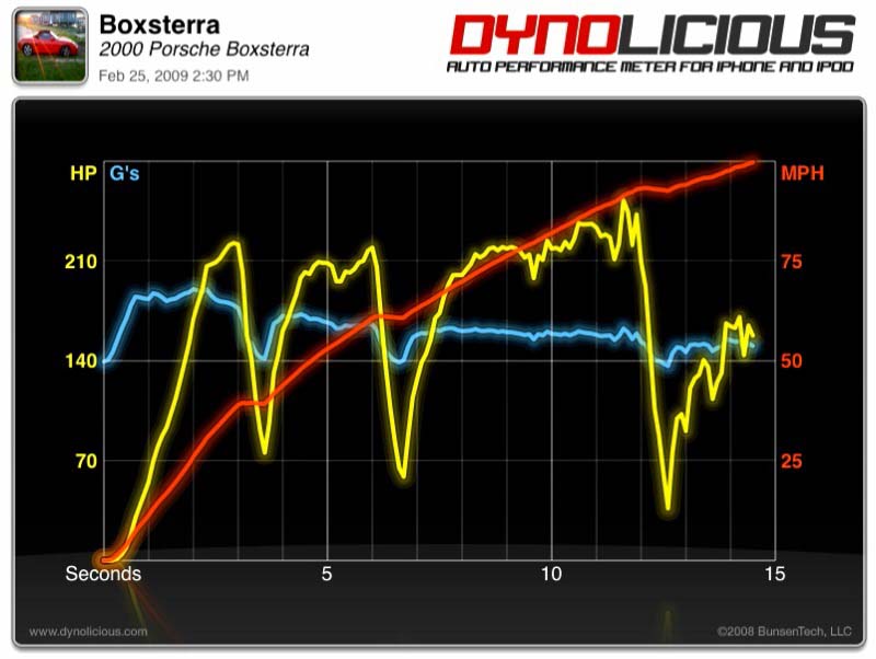

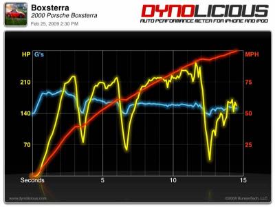

I am experiencing a problem with my 2000 Boxster 3.4 liter. The car under acceleration pulls strong though 1 gear stumbles slightly through 2 gear but starts to really have a noticeable stumble in 3rd gear approaching 5000 RPM and actually sounds like it starving for fuel but then catches and accelerates up to 7000 Rpm.
It a similar feeling to fuel detonation in older cars with bad gas.
I try to attach a photo of my Dynolicious chart where the yellow line can be seen showing where it stumbles…

I tried your suggestion and the performance was slightly worse..
Here are the CEL codes and Fault codes produce without the MAF connected.
P0455 Fault 94 Tank vent System Error Major Leak
P0102 MAF Fault code 115 Below limits (Not Connected)
P0112 Fault code 124 Intake air temp below limit value
Additional Information From Durametric not sure what values to run for analysis?
