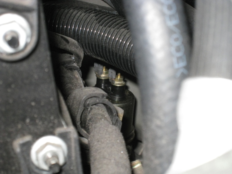

If you open the engine hatch and look on the right side, deep into the engine compartment, the sender is nested there. I bet it could be replaced without special tools albeit very tight space.
I attached the photo showing the two shiny terminals and the body of the sender, which is actually brass color (it shows up as black in the photo because of lighting). BTW, the gauge should read 0 when the engine is not running and ignition is in position I/II. When my sender went bad, it actually reads > 0.
are you sure this is the oil prsesure sender but not the variocam actuator?
