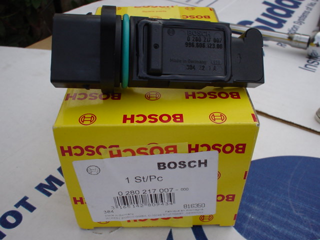

I do not see that Bosch part number on on the 2.5 sensor or the box it came in. Maybe an internal part number used by the aftermarket company that sells them?

This picture is a 2.5 sensor so do not even look at it for part numbers. Has no application on your car.
