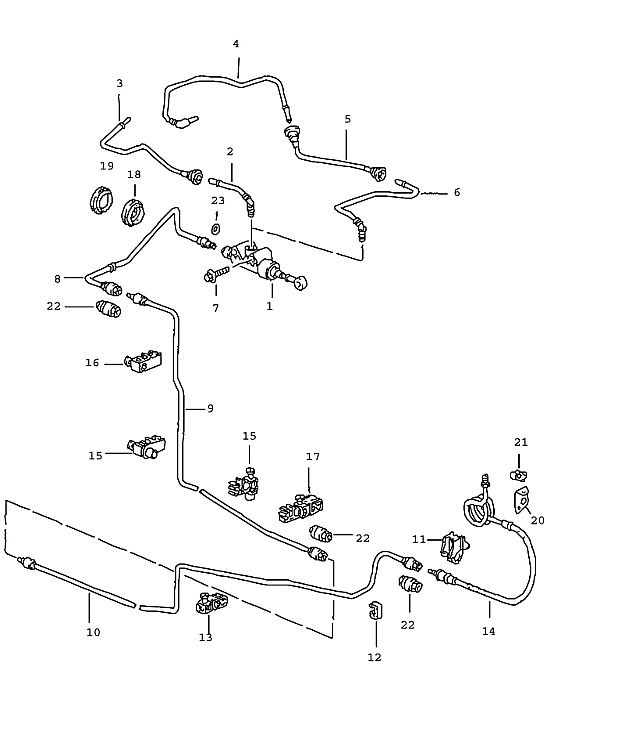

Maybe this will help.
We can get you the part number if you tell us which one is broken.
Porsche Parts at Dealer Cost the link above will be your best price.
Thanks. It looks like I'll need #22 and #14. Presently the end connection from #14 won't connect into #22. How does the #22 connection come off the hydraulic line? Or am I looking at replacing the line also? Is there another way to fix the connection?
I was finally able to get the compression fitting off. It was very tight. Inside the fitting is a small clip that was broken. I've ordered the replacement circlip, part number 999.230.685.40. Hopefully next week I'll be able to get it all back together.

Old topic, but I just had the same issue arise. I found a crack in, what I believe is the #9 line. It's blue and I'm wondering if there is any way to confirm that is the line that I need. There is a small crack right where the line clips to the underside of the car just behind the front left wheel. Any information would be greatly appreciated.
