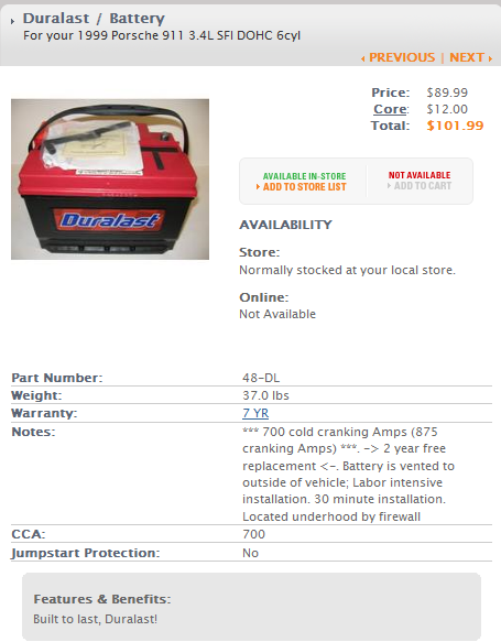

My first Porsche battery experience was in 1975 - just bought a 71 911T from my brother. He left the country and then the car wouldn't start. Went to the dealer and found out that there were two 6 volt batteries to be replaced - one in each front fender well. Maybe $160 ($80 each??) but in 1975 that was a lot of money to me.
that's a ton of dough for batteries esp given that a brand new 996 battery 2009 costs $120.
I replaced the battery in my MY99 in 2004 - so I was lucky and got 5 years. At that time I paid $69 for an Autozone battery.
It is now just about 5 years later and the Autozone battery is still fine - still I expect to replace it by the end of the year. And the price is now $89.

Interesting that the install is characterized as "labor intensive" - obviously Autozone isn't familiar with P-cars :)
