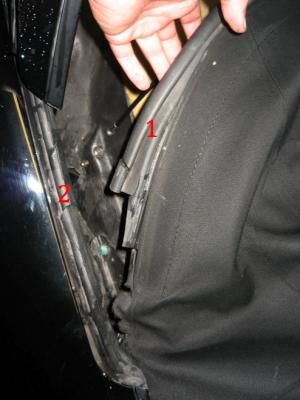

This picture is from the right side. It is pretty bad I think, notice the hole that has been made in order to access the bolt underneath, DUH! After removing the transmissions and bolts for the top, drain tray is hanging far away from the body and the water went straight in as the gaskets are what they are...
I think that DIY was not ex-owners thing, I am so glad that the box under driver's seat wasn't damaged.
I have some black Loctite 5922 around that would do the trick if the damage was smaller. First I was thinking about patching the big hole(s) with similar material and sealing with Loctite but in the end I am not sure how good it would last.

Placid:
Nice pics. They tell the whole story.
Definitely recommend replacing them.
It's not worth taking a chance on sealing them because the damage is pretty bad. You already know that if you get a leak into the passenger compartment you could be looking at an expensive repair or replacement of the central alarm control unit.
Do a search here for the procedure on the top and frame assembly removal, or go to Mike Focke's pages for the same procedure: http://mike.focke.googlepages.com/thetop-i...e%26replacement
Look under the subheading "Removing the Top and Frame".
Regards, Maurice.
