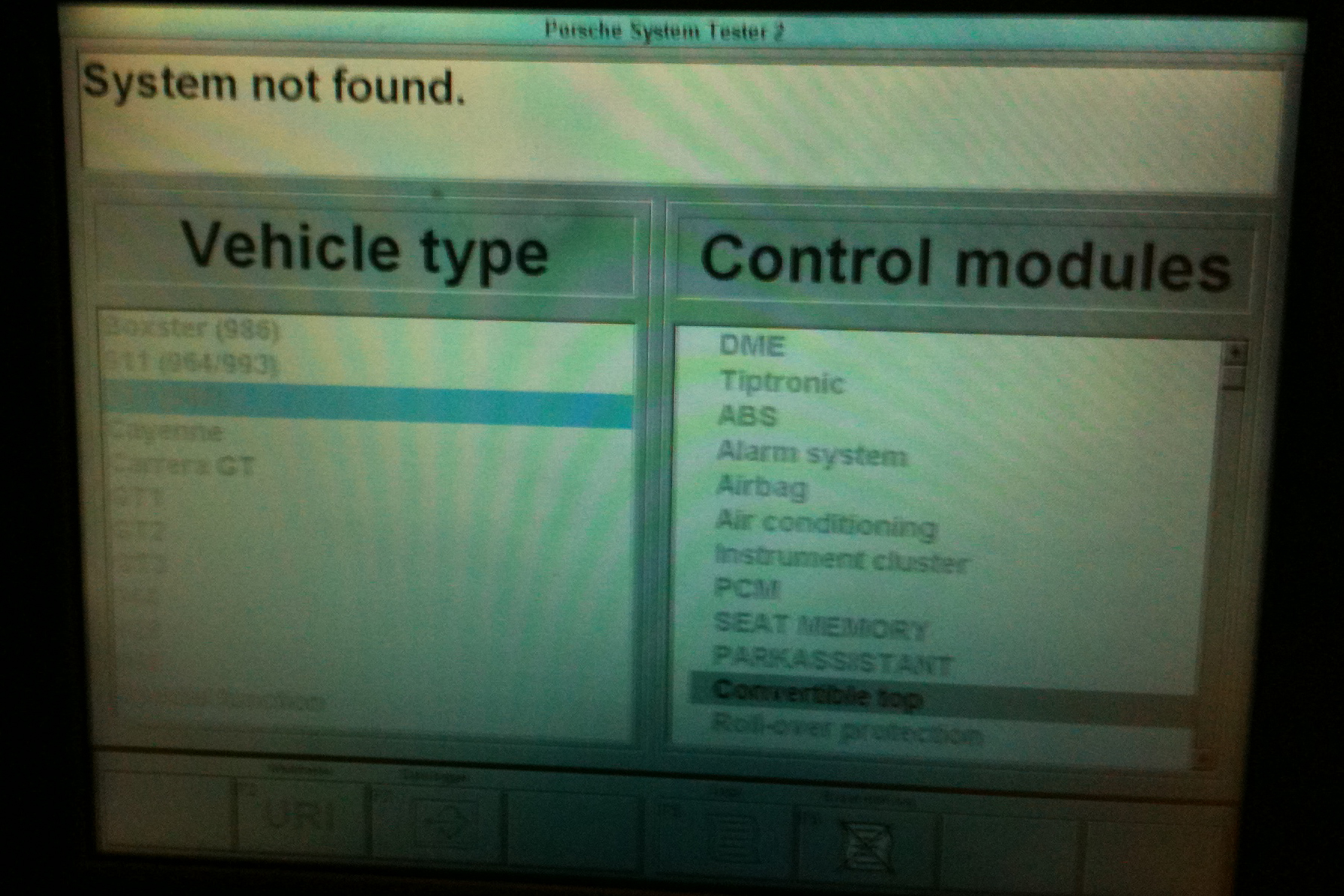

When I try to check the convertible module with my PST2, it just says it can't find module. When I connect to the DME, it has no codes.

Since the convertible control module isn't speaking to my PST2 or my Durametric, and it's the only thing I can think off that would control all four windows, I'm assuming it's gone bad.

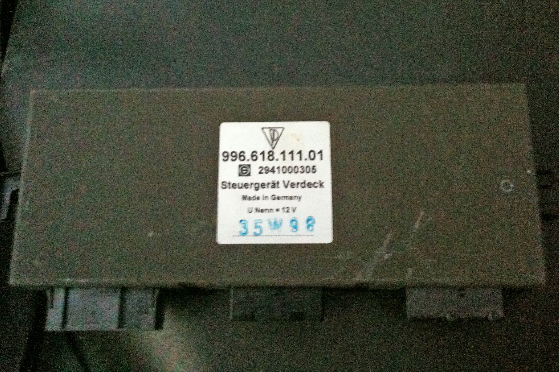

I pulled it out, so I don't have to deal with devil windows the rest of the week. I'm going to call the dealership tomorrow to see if they can test just the module. If they can't or if it tests bad, I'll order a new one and see what happens.
Apparently nobody can diagnose the controller unit out of the car, but I don't have time to put it back in the car until this weekend. I also don't know how they'd diagnose it since I can't get the PST2 or Durametric to connect to it anyway.
I ordered a new convertible top relay from Sunset because it's a cheap swap as a "just to make sure" thing. I also pulled the dash switch to check the wiring, but it all seems to be connected, and the switch itself seems to be working.
The controller unit is $458, so I'm not in a hurry to spend that before I've exhausted all my other troubleshooting options.

Progress. I got a salvage convertible top control module from Oklahoma Foreign for $150, and it now speaks with the PST-2. I'm getting error 5 Maximum Time Exceeded (timeout).
