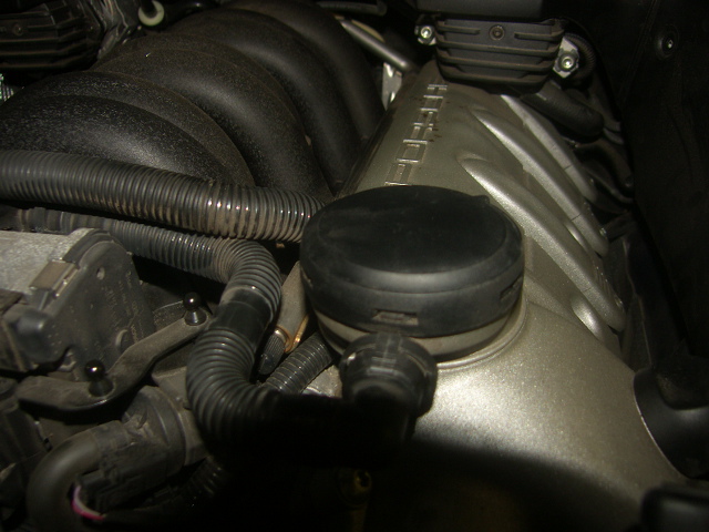

Hi on the driver side valve cover in the front i have a vacum leak from the black cap what is the name and does it come off or does it have a gasket?
Are you sure it is leaking?
Do you get a fault code?

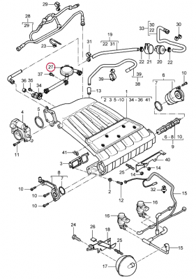

955.110.765.00 Valve crankcase bleeding -- US MSRP $73.87

Thank you yes it gave a buch of codes cam sensor misfire on 4 idle control valve it makes a leaking sound but if twist the cap a little it will stop until the next start is leaking from the base if the black cap. Is that had to change?
2004 s 4.5 v8 61000 miles
Ignore the diagram above then - it was for a V6 Cayenne.
That part is still the crankcase bleeding but I am not finding it in the parts system.

Hi Loren i check the fuses and also for broken hoses nothing could the oil separator be the problem does the v8 ave a aos do you know the location you are correct the first code will set of the others
Sorry, if you can't see anything obvious it could be a time cracked hose somewhere and only a PIWIS will help diagnose where.
Thanks a friend suggested the oil separator do you know a quick test. He suggested taking the oil cap and checking for suction I did and it suck my palm very strong like a vacum cleaner

this a cayenne s if you look a v8 turbo diagram for 2007 the parts shows in the diagram as oil separator

It is true they sometimes get a small hole in them and can have an effect on idle and such. Also true that Porsche only sells the whole cap. Pelican parts or somebody use to sell this rubber diaphram for something like $20 but if it can't be found anywhere else and your trying to trace down a vacuum leak this could be the good (only) deal around without having to replace the whole (stupid) valve cover.
http://www.pelicanparts.com/techarticles/Porsche-Cayenne/69-FUEL-Fixing_Common_Vacuum_Leaks/69-FUEL-Fixing_Common_Vacuum_Leaks.htm
http://www.pelicanparts.com/techarticles/Porsche-Cayenne/67-ENGINE-Repairing_the_Air-Oil_Separator/67-ENGINE-Repairing_the_Air-Oil_Separator.htm
Edited by hahnmgh63
I just bought that diaphragm off eBay, but I have had a he'll of a problem trying to get the black cap off. If you are able to replace it I would be interested in how because I followed the instructions on pelicanparts but it did not come off as described for me.
I bought this directly from the guy's website (vanos-bmw.com) because, at that time, according to the seller eBay had frozen Paypal accounts in Russia. The part came rather quickly considering it came from Russia and I installed it using the Pelican parts guide. no problems. Seems to be a good seller.
