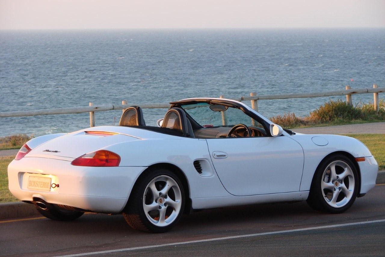

Engine Upgrade - Boxster S Engine vs oem 2.5l engine
Hi from OZ!
Sad story - started an upgrade project for a 986 1997 Boxster - but bought a Tiptronic car- vs Manual
Obviously want the car to be manual for track!
Porsche Dealer who started the upgrade had estimated the tip to manual conversion would cost approx $AUS 2,500 extra
- pedal box, cables etc
- this was factored by me into the purchase of the car (not bought from the dealer)
- I sold the Tip in exchange for a 5-spd box
Accessed a Boxster S engine, bored to 3.4l & fitted with Sports cams etc -Porsche X51 package
- circa 260kw
Now all involved are worried as its an ex-TIP, the cost to do the complete manual convert could be a huge unknown & further, we will never be sure all the car’s electronics will be “talking to each other” – ie ABS, Eng Mngmt, etc
Situation:
- worked 3.4l engine sitting on wooden blocks in the car – ie not connected to transmission etc
- was a big job to strip the car down & make space for the 3.4 l engine!
- Dealer got it to start
- manual 5spd box ready - will need upgraded clutch/flywheel
-manual wiring harness accessed – but looks a little tired
Was using the Tiptronic to start a fatal decision?
I'm now "half pregnant" - ie will cost real $$$ to convert back to original Tip car & sell!
- or cost a potential huge $$$ to complete as per plan
appreciated
Justin :)
