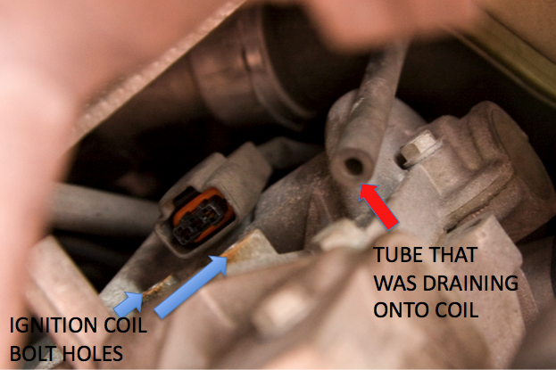

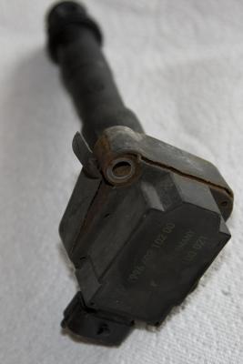

I put the car up on jacks and took a look underneath. Sure enough, didn't take long to see that I have a cracked coil.post-44654-1249692174_thumb.jpg
I assume the primary cause for the coil erosion likely stems from the tube depicted in the picture. Can I assume this is a water drainage tube that should probably be routed somewhere else?post-44654-1249692889_thumb.png
-Rob

Changed out the #1 coil today and that did the trick - no more CEL light, fault codes, or rough idling. Figured since I'd already started the process, I might as well change out the spark plugs and remaining coils. Turned out to be a good decision as the #4 coil was cracked pretty bad also.
