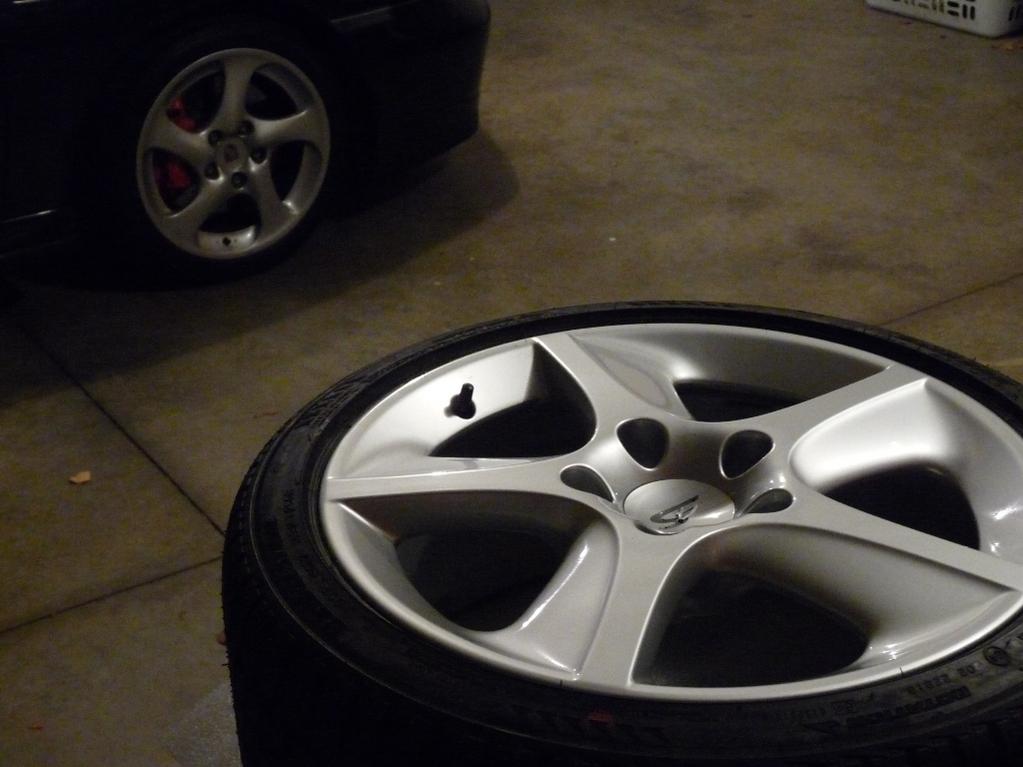

The best way to go is to put dedicated winter wheels on your C4S. I have a set of dedicated 8x18 fronts and 8x10 rears. It's important to select the proper offset for your wheels since you are downsizing to a 10-inch width in the back. The recommended front offset remains ET50, while the back should be ET47. If you use this combination, no spacers are required on the rears. I'm running 225/40/18s on the front and 265/35/18s on the back, as recommended by Porsche. I bought a new set of Blizzak LM-25s this year, at a great price.
There are OEM wheel options available, as well as aftermarket wheels in the proper size and offset. I went with replica Sport Techno wheels that are made in Italy.
