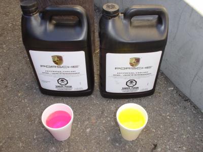

Why? If they used either of the two Porsche coolants you should be fine.
Both the old (greenish-yellow) and new (pink) Porsche coolants can be mixed.

Not unless it is really bad tap water. Porsche just says "water".
Intermix problems are a bad head gasket or a cracked cylinder liner in most cases.

Loren,
Are you absolutely sure that the old greenish-yellow and the new pink Porsche-sourced coolants can be mixed? I have had two PCNA techs tell me just during the past month that if you mix the new pink with the old greenish-yellow coolant they will gel and cause great harm to your engine. They further told me that the old greenish-yellow coolant can be mixed with the blue BMW coolant without the gelling problem. Are there any factory tech update notices on this?

It has been discussed (and done here many times).
The PORSCHE coolants are compatible but other brands may not be.
(pic courtesy Tool Pants)
http://www.renntech.org/forums/index.php?s...ost&p=56360
