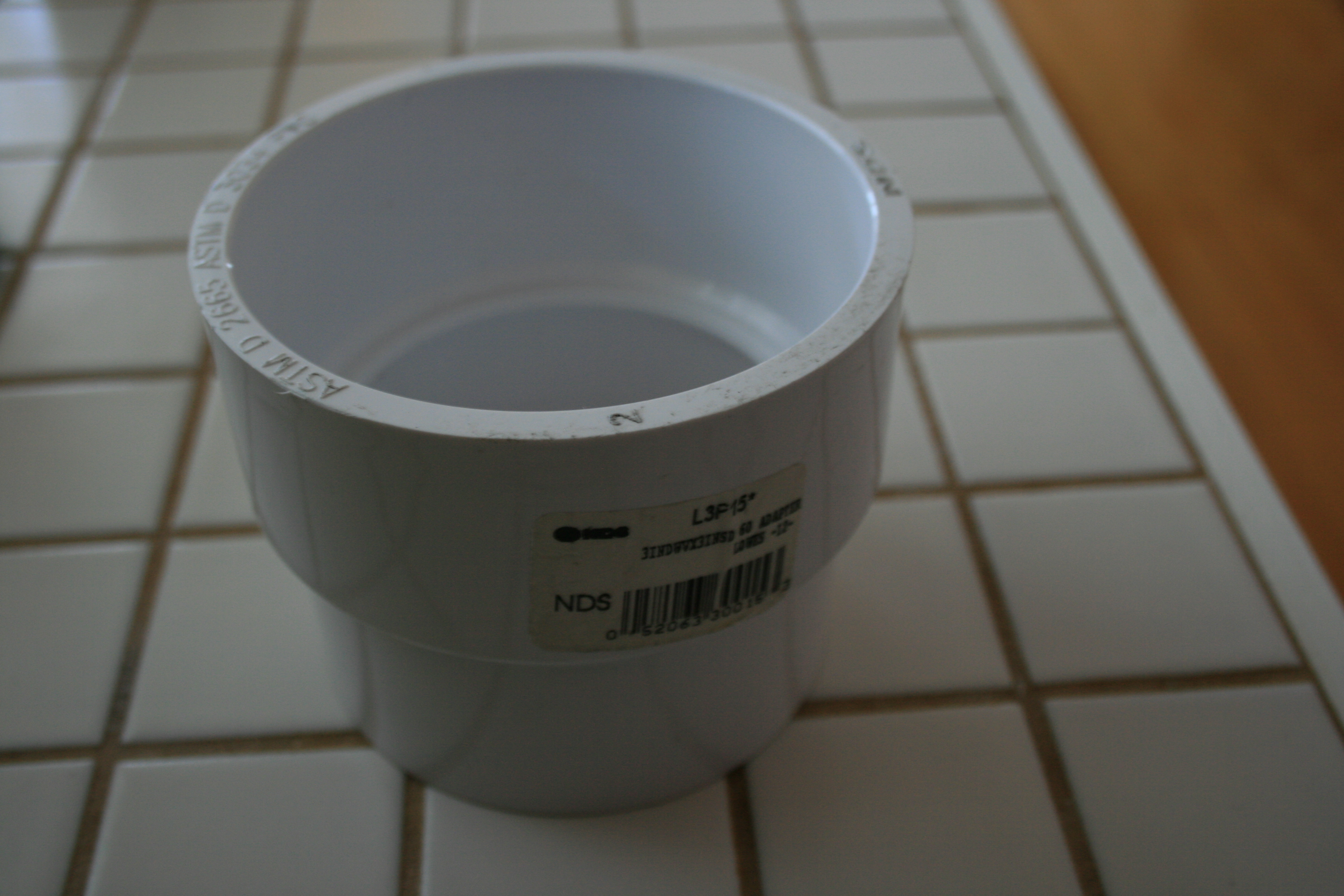

I changed my Clutch, Flywheel and RMS by myself without any experience. If you do it have good stands (higher than normal ones), a tranny jack that sits low. I did not get a RMS tool. I just bought a $5 plumming joint that was the same size as the RMS seal and tapped it in place.

I bought it from Lowes. It's a PVC adapter that is the same size as the RMS seal. When you get the RMS seal, take it with you to a hardware store.
I placed it on top of the RMS seal and tapped lightly with a mallet evenly untill it slid in it's place.
The old RMS is hard to get out. I used a small drill and drilled a hole on it. Then I screwed a screw in it and pulled it out.

Hey Kristian, can you post a pic or more details of that plumbing joint and how you used it?
