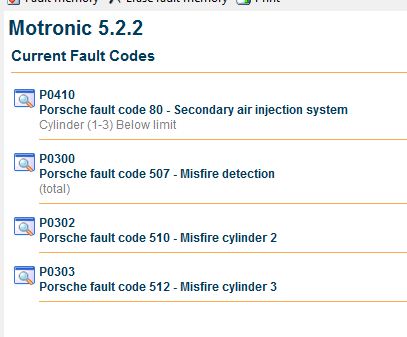

P0410 Secondary Air Injection System - Signal Implausible (Cylinders 1 - 3)
P0300 Misfire Damaging to Catalytic Converter
P0302 Misfire, Cylinder 2, Damaging to Catalytic Converter
P0303 Misfire, Cylinder 3, Damaging to Catalytic Converter
Seems that all the problems are on the engine bank (cylinders 1-3).
