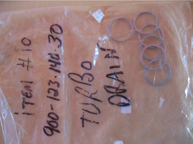

Bostonduce, I just look at my stock and they are crush washers part # 900 123 044 30 (see pics). This part becomes really hot and I doubt rubber would stand the heat. Turbos become red hot under heavy load.... Sorry if I am wrong but.... Just did a search at Pelican site and part# 900 123 044 30 is a crush washer...(there is a picture of the part)

2. In my case the turbo drain plugs had no washers in place at all !! - and yes I checked very carefully that they weren't stuck to the plug or in the tank recess. I re-assembled everything per the correct torque settings sans washers and all seems well, no leaks. But I suspect I may re-visit this and install washers as shown above.

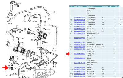

BD . I did a search in PET with part# 999 701 598 40 m17 and this part is applicable to 911 year 1989 and 964 year 1984 ??? It is not the first time Pelican had wrong information on parts but I always double check with Porsche parts cat and so far never had a problem. I hope you are aware of this good site for part# search AutoAtlanta, it is very useful but the parts are a bit expensive...
Just found something else the 999 701 598 40 is 18.65 X 2.45 and the one called by Porsche is 18 X 22

Ok you guys, you had to make me get down on the ground to check. :)
There is no crush washer on original 996TTS turbo reservoir tanks.
It's a recessed plug that takes a special hi temp o-ring.
Part number 999 701 598 40 from my last parts purchase. Curious that Auto Atlanta lists the part number, but it's no where to be found on the exploded diagram.
Most respecfully, it appears the PET is incorrect, and has been for years- can't see why they would supersede a crush washer when originally sealed with a o-ring.
Yes, the alumininum crush washer will 'work', but it can/probably will leak unless it's over torqued.
