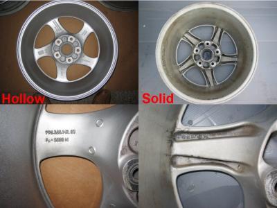

The very early 996 Turbos (like mine) were fitted with solid spoke TurboII wheels as standard, and hollow spokes as an option. The hollow spokes became standard not long after.
Maybe I've confused things.
When you say 'flat back' do you mean smooth faces? The hollow spoke TurboIIs have a smooth face, and the solid spoke have two ridges in them.
What option code wheels are they? If they are M415, then they are solid spokes. If they are a different code, then the only way to be sure would be to take them off and check the part numbers cast on the back.
Thanks for the pictures! It makes sense. I have to check my wheels to see what I have.
