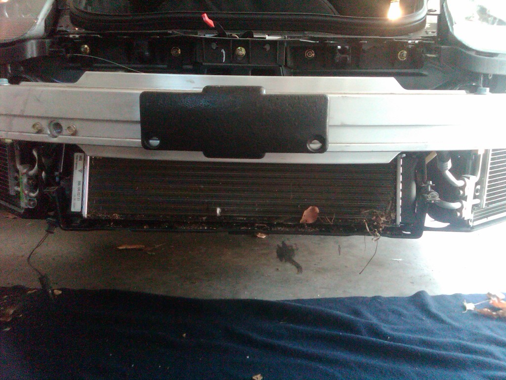

Hey all, I finally did the horn replacement two weeks ago and cleaned out the radiators, ac condensors and oil cooler too. I bought the horns from Pelican Parts and followed Skyler's DIY blog and it really wasn't too hard. Got it done in about a 4 hours total. I also replaced both horns as long as I was in there and put the horns in with their trumpets facing backwards, in the hope that they won't fill up with water as easily and last a bit longer. The only thing I can add is that in removing the wheel well liners, there is an extra plastic rivet/button on the passenger side behind the MacPherson strut as the wheel well liner on that side has to cover the fuel tank inlet.
In fairness to the dealer I rechecked their price quote. The $190 quote was for parts and labor. But I still did it myself as I wanted to clean out the radiators,etc. which I didn't think their price included and I put the new horns in facing backwards which I didn't think they would do for me. For a fair-weather car with less than 21,000 miles on it, there were quite a few leaves in there.
My next project will be to sew back on the 2 convertible top velcro holding straps, part number 986 561 931 00, which have come unstitched from the top and are just hanging around the frame support tubes on both sides of the car.
Thanks again for all the advice.
