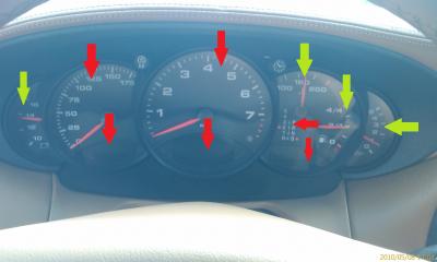

Hey guys,
I am wondering why my instrument cluster does not work anymore completly. It happens a few days ago, the rpm counter and the speedometer indicator are not moving anymore. After that, the odometer, clock and the digital speedometer was also not working anymore. Another problem is the tiptronic display. The red light toggles between "D" and sometimes "2" or "4" while am driving. I already disconnect and reconnect the three connectors behind the instrument cluster. But it does not help. Attached you will find a picture of my instrument cluster. I have marked the working instruments with a green arrow, the not working with a red arrow.
Do you guys have any ideas what to do? Does anyone has a wiring diagramm of the cluster? Please send to tacoma1@gmx.net
I hope my cluster is repairable.

And if you wiggle the ignition switch with the key in it? any affect?
Bad ignition switches can cause all kinds of strange electrical problems.
You mean i should wiggle the key while the engine is runnig, right?

@ Loren:
For my understanding, all instruments and displays with the red arrow in my attached pictures are using ABS-signal (except the clock :-)) from the wheels? could it be, that those sensors are sending "signal not valid" signals or no signals to the ECU of the instrument cluster ? The tiptronic is shifting normaly while i am driving. So i guess, the ABS signals are o.k.
Doesn't matter if it is running or not a bad ignition switch will often cause strange things to happen and even more strange things when it is wiggled.

Just checked my ignition switch. Nothing happed while i was wiggling the key. Any other ideas?
You are likely going to need to put a PST2 or PIWIS tester on the car run diagnosis on the instrument cluster.
If you are lucky it is a loose connector - if not a bad cluster.
Where could this lose connector be located? Somewhere on the engine?
