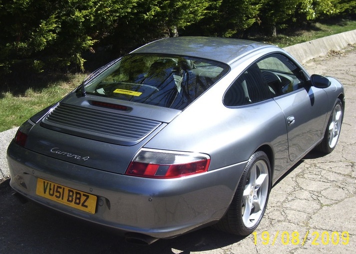

This is a picture he sent me. To me it looks NB.
Edited by 100
Yeah I seriously doubt he widened the rears.
It's a narrow body. I'd also be skeptical that it's a C4, there's no "4" on the back. Get some photos of the trunk (should be shallow and shaped differently than a C2), or the calipers (should be silver).

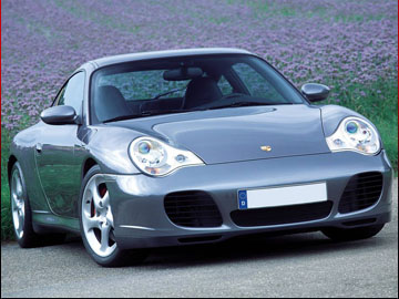

Theres a few easy visual spot checks to tell the difference between a C4 & C4S
1.The C4S has the Turbos larger air intakes in the front bumper.
2.Wide-body rear wings (60mm or 2.4inch) to be exact.
3.The biggest clue is at the rear where you'll see a large diagonal reflector strip. (which is non illuminated thats a shame really, it would look cool)
The C4 has a more subtle body silhouette and is identical to the C2 in appearance other than silver callipers.
Also look in the boot area and you'll see if it's a C4 or C4S the boot will be smaller more shallow (about a third) over a C2,
this is because of the C4 4-wheel drive system.

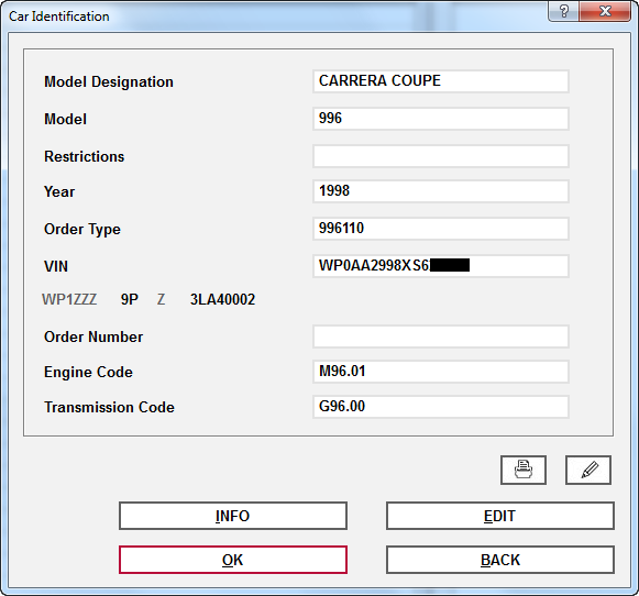

PM me the VIN and I will tell you what the factory options for that car were.

996110 = Carrera (2) Coupe
C4 was not introduced until MY1999.
996410 = Carrera 4 Coupe
996411 = Carrera 4 Coupe RHD
then in MY2002
996430 = Carrera 4S Coupe
996431 = Carrera 4 Coupe RHD
