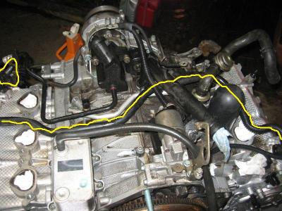

Another thing that may or may not be related: I have some oil puddle on top of the driver side cylinder head-to-block valley area. The passenger side is perfectly dry. Could be a head gasket, but then again the power steering overflow line is just above that location, and also the breather line from the AOS. I know I have overfilled the power steering fluid in the past, and the AOS breather outlet looks very oily and gunky. Perhaps the AOS has failed badly and is pressuring oil out of the breather tube?

A couple of things. I'm not sure what you mean by breather hose on the air-oil separator, there isn't a breather attached to this unit? Are you talking about the vacuum hose attached to the manifold?

Wayne, please see the attached picture (not mine, taken from the web). The yellow indicates the line that goes from AOS to a breather valve on top of the driver side valve cover.
