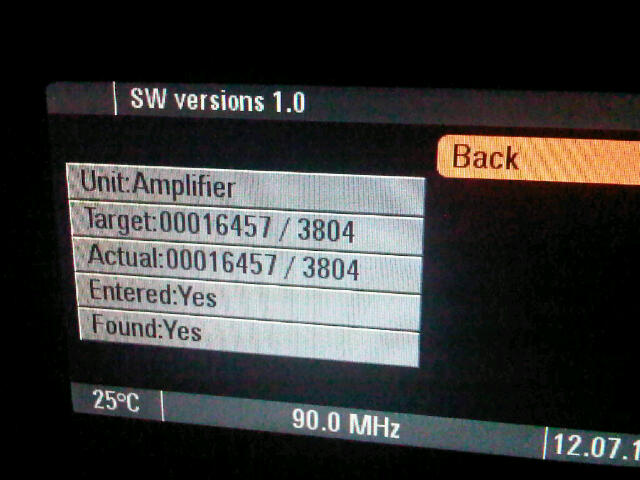

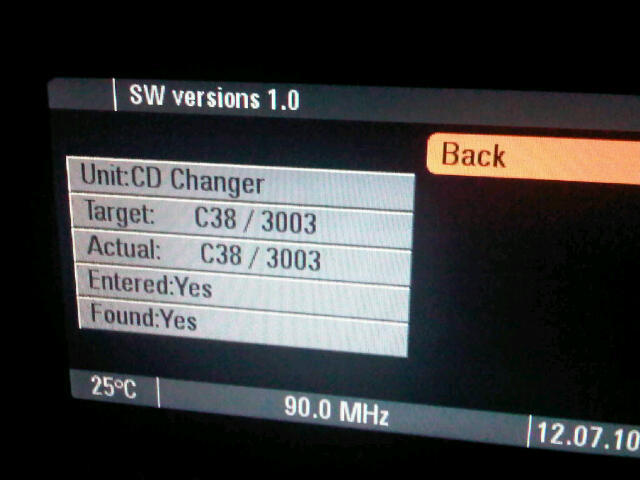

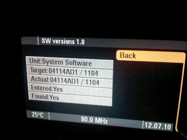

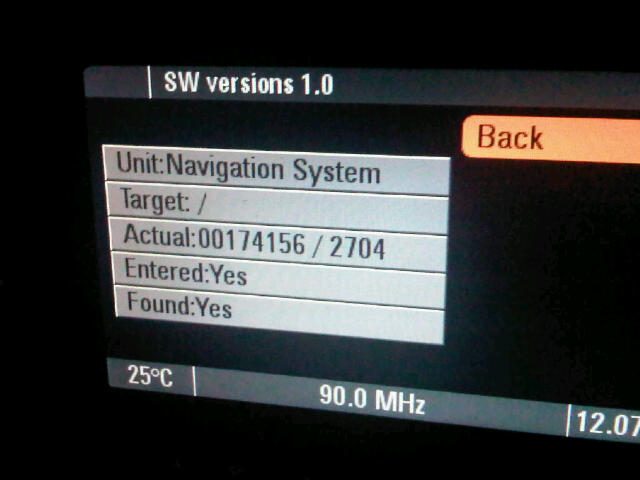

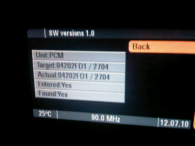

I have recently bought a 2005 Cayenne and the Satnav is using an out of date DVD 997.642.235.03. I managed to find a more recent Navigation DVD (997.642.255.04) on eBay. Reading in the forums I understand that I would need to upgrade the firmware on the unit before I can use any updated DVDs.
I would be grateful if anyone could advise me on the upgrade process. The car has the Bose amplifier and Navigation units. Please find attached some screenshots of the current software versions.

Hi,
your PCM unit version shows 04202xxx, e.g. should be model level A, but the SW versions shows 1.0, indicating model level Standard. I guess your model level is somewhere between Standard and A (SW versions 2.x).
New DVD Navigation discs (maps 08.2007 or 08.2009) are compatible with PCM 2.1 Multimedia model levels B and C only.
Thereafter, you have to update PCM 2.1 Multimedia unit up-to the model level B (SW versions 3.x / PCM unit 05024xxx) at least. Navigation system update CD and Navigation maps DVD are common for 955- and 997- kits.
Thereafter, you need either individual PCM 2.1 Multimedia model level A (first step) and B (next step) update CDs for CAYENNE, or similar CD set from 955- kit (e.g. for CAYENNE). Update process can be complicated, because Bose Amplifier and CD units may require additional repair kit CDs (if update CD are not from the latest kit release). I strongly recommend to find someone experienced, or at least to study corresponding TSB (installation and conversion instructions).
Read also this helpful topic: http://www.renntech....upgrade-update/
