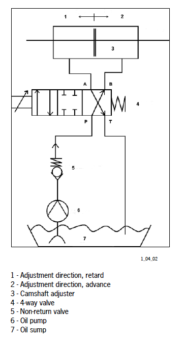

Here are some diagrams of the oil circuit and the oil supply from the 4 way solenoid valve to the vane adjuster on the camshaft. Essentially the solenoid valve is a 4-way proportioning valve that connects one of the control lines ( A or B ) with pressurized oil from the feed line P and open up the other line to allow oil to flow to the crankcase. If the A line is pressurized the vane adjuster is turned to advance, if B is pressurized it retards. In the center position both lines are closed and the cam maintains its current position. Intermediate positions between A fully connected or B fully connected to P are also available allowing for slower but finer changes in cam timing. Therfore the valve controls both the speed and amount of cam timing changes in contrast to the on or off cam timing on the earlier cars. The non-return nature of the valve allows for proper cam timing changes under low oil pressure conditions such as low engine speed and/or high temperatures.
Hopefully, these diagrams don't violate copyright issues on the site as they are taken from Porsche technical publications. If they do I apologize to Loren and feel free to remove them.

Thank you, that is extremely helpful. So, after looking at this schematic, since this is a hydraulic system, that has the issue of performing slowly at low RPMs, I would think the problem could be either in the supply or drain side, as either one would cause too slow of a movement at the vane cell adjuster. Is it reasonable to suspect that the non-return valve on one side is not functioning, and that is why this issue presents itself only at low RPMs? Where exactly is that valve? I know there is a check valve inside the the finger screen that sits directly behind the solenoid valve, is this the non return valve in the diagram?
I suppose the only evidence working against the culprit being the non-return valve, is that this problem actually seems to get better as the engine warms, and the oil thins, so that would point away from the non-return valve being the issue.
Back to the idea of using air pressure to blow out these passages, that seems relatively easy to do to blow out the supply side (P) by blowing air back down that way from the valve port, but to blow out the returns, I imagine you'd have to blow air up from the sump?
