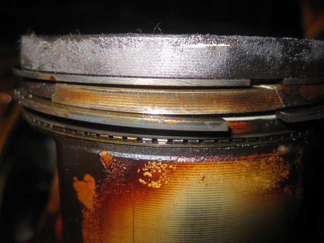

We just finished a rebuild of a customer who had a turbo in his 2.5L Boxster
over boosted it and broke the ring landings on the pistons.
Bore of engine wasn't even close to being in spec -- but no idea if that had anything to do with the turbo
charging -- although I expect it did.
I highly recommend an intercooler.

Wasn't my car -- It was a customer's car -- don't know what they had it boosted to.
All the turbo equipment was removed -- when they drove it to our shop.
Here are some pictures.
Block was many mm out of ovality as well. Had to bore it out, replate with Nickel Silicon Carbide and hone back to factory spec.
After we get past the break in period of the rings -- we'll give it a dyno test.
Mike

Thats really in interesting Mike. I've never seen the sort of damage FI can inflict on one of these motors (assuming it was the fi).. What do you attribute the ring issue to, an over heated charge(I.E insufficient inter-cooling)? Ovaloid cylinders, sort of an over-force projeced in the wrong direction (detonation or over compensated timing? doesn't look like really excessive wear or slap on the pistons? Will the sleeves mitigate this problem if an unavoidable byproduct of FI? and "D" chip potential?
I ask because I want to build a back up engine for what I sort of consider the inevitabilities of my current setup.

That really in teresting mike. I've never seen the sort of damage FI can inflict on one of these motors (assuming it was the fi).. What do you attribute the ring issue to, an over heated charge(I.E insufficient inter-cooling)? Ovaloid dylinders, a sort over-force induced? doesn't look like excessive wear or slap on the pistons? Will the sleeves mitigate this problem? and "D" chip potential?
Correct me if I'm wrong, but that looks like the ring lands failed - my guess would the weak cast pistons as I mentioned as I've seen ring lands be the first to go on other NA engines running FI. Could be catalyzed by an older, worn engine; obviously can't tell a whole lot without inspecting the rest of the engine or knowing what the heck they were running. I'm definitely curious whether there's more tell tale signs of what did the engine in.
There was a guy around here with 2.5l with 110k mi, and twin turbos at about 300whp...don't know what happened to it...or him
obviously can't tell a whole lot without inspecting the rest of the engine or knowing what the heck they were running. I'm definitely curious whether there's more tell tale signs of what did the engine in..
So am I, really curious what goes bad and why in these things. Love to know more about this one. I want to build a GT "also ran" one day that won't blow apart. It's seems 67 HP per hole isn't unreasonable. They do more in Subaru's.
