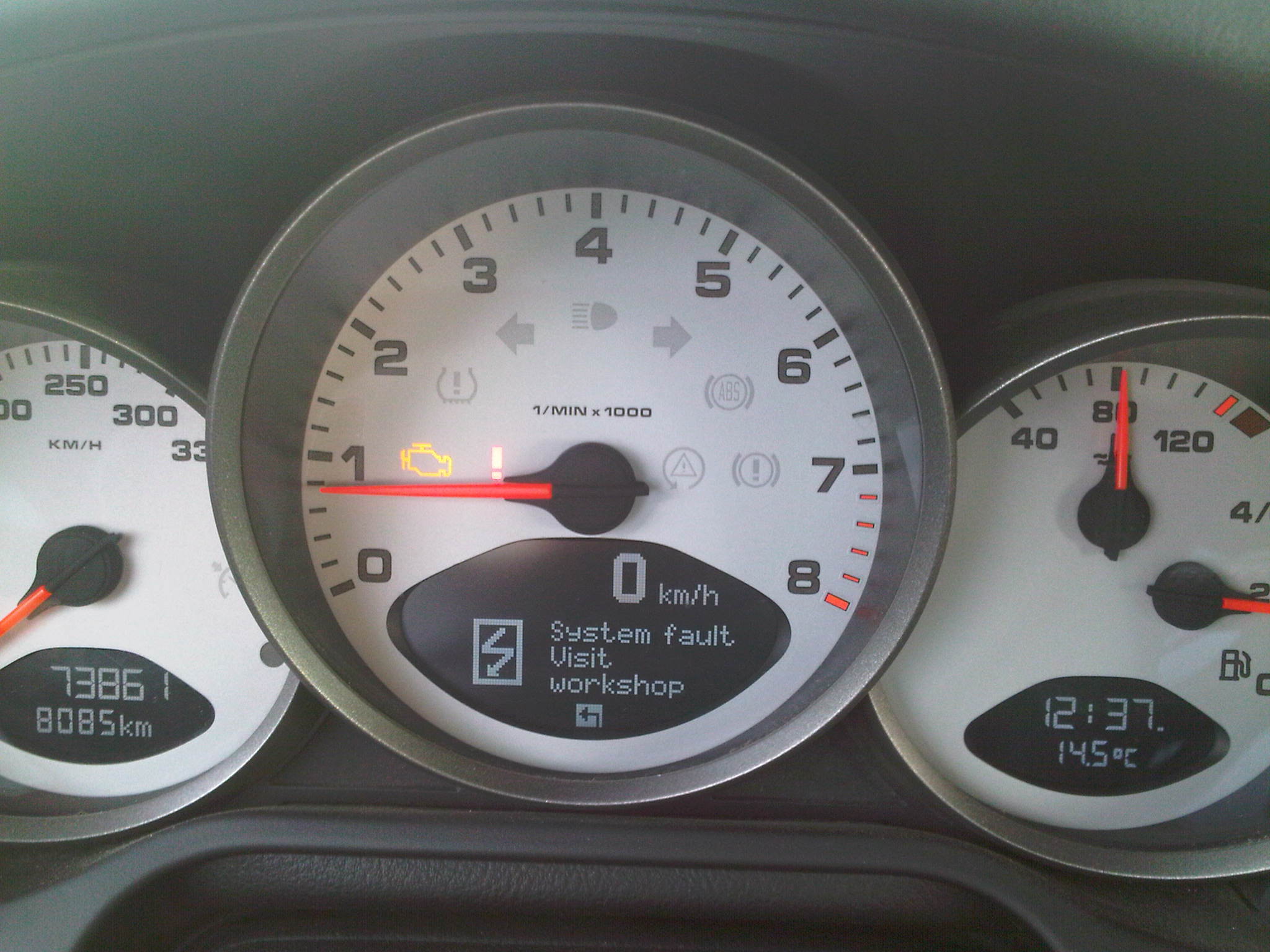

The past couple of days I've also got the following on dash:
post-43497-0-63693400-1289922010_thumb.j
Any help is appreciated
