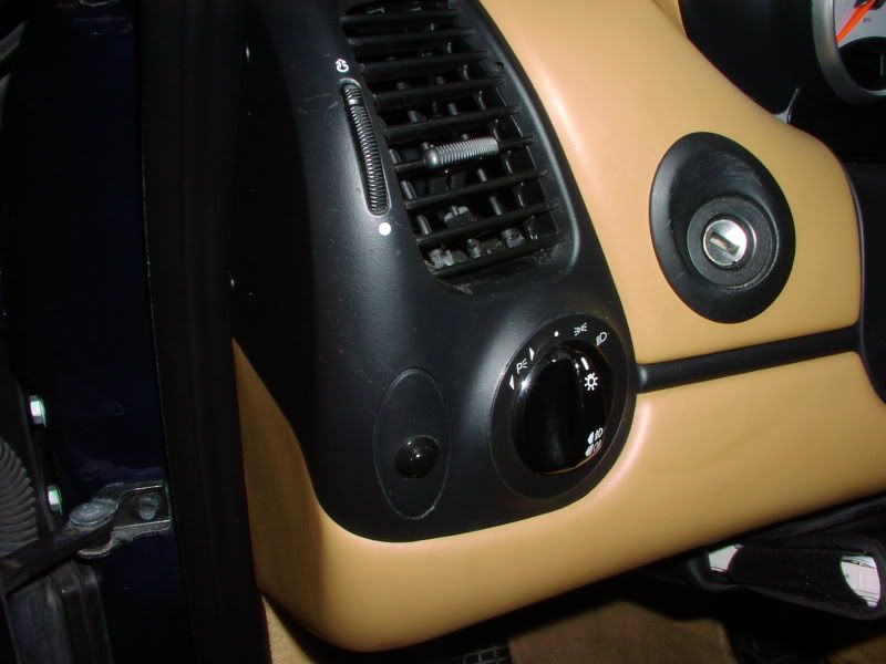

My first Porsche (a 100,000 mile 2000 Boxter S tiptronic) and my first post here. This may be the dumbest question ever but I couldn't find the answer in the owner's manual. There is an unmarked button just to the left of the headlight switch and I'd like to know what it's for.

Here is a crummy picture of the car and the switch I'm confused about.
The elliptical opening was for a microphone component of the OEM phone system, rarely seen on these cars. The blanking insert is a favorite location for a small push button installed post delivery to operate a garage door opener, usually hidden under the dash. I’d start there……………
It appears to be an owner added switch. If that button is a momentary on (push and springs back)I would assume it is wired to a garage opener under the dash somewhere. If the button locks in the on position, then I would start looking for changes in lighting inside and out (daytime running lights, fog lights, back up lights, etc).
Not to be too anal, but....
The microphone for telephony as well as ambient cabin noise measurement (for GALA volume adjustment of the radio) is in the instrument cluster. The little plug that is on both air vents (for LHD/RHD cars) is for the manual headlight leveling adjustment control that is used on many ROW 996 and 986 cars.
As many have said, in this case, the button was probably installed by the previous owners for a garage door opener or alarm or some other owner installed equipment.

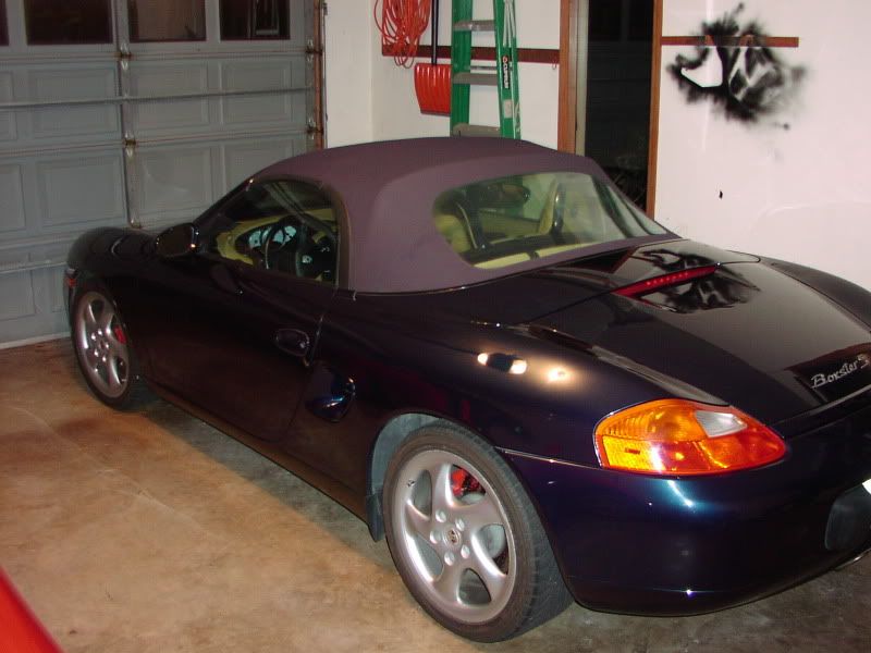

Great looking top, I want that color for my Arctic Silver Boxster. Do you know if it's OEM?
Looks like the top is Metropole Blue on Lapis Blue Metallic or Midnight Blue Metallic.
I don't anything about the history of the car except for some recent repair receipts. The top looks original to my eyes but I don't actually know. It certainly has enough rattles & squeaks to have been on the car for 100k miles.
