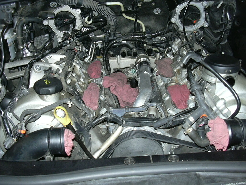

Anyhow, got it to the shop and pressurized the system. I could hear the leak at the rear but there is NO SPACE to see or feel anything. I debated whether or not to remove the drivers side cat but I eventually decided to remove the intake man.
Once the manifold was out, I found the leak at the plastic T behind the engine that has a rubber hose connected to the 3rd (infamous) coolant pipe. The T broken at the flange where the hose was connected where non removable clamps are used. Here is a pick I borrowed from someone else on reenlist:
There was absolutely no space whatsoever to work back there. My hands and arms are all cut and bruised after this fiasco. Went to downtown porsche in Toronto and they claim to never have stocked this part but found one at PFAFF just north of Toronto so I drove up and picked it up for $38 - not bad for a Porsche part!
The worst part was definitely working back there. It probably took me longer to disconnect and reconnect the 3 spring clamps then R&R'ing the intake mani (and this was my first time doing this job)
In the end, I would recommend anyone who is doing the coolant pipe replacement to also take the extra time and replace the plastic T that includes the 3 hoses connected to it for piece of mind. Otherwise, down the road at some point u will be removing the intake manifold to replace the T as well.

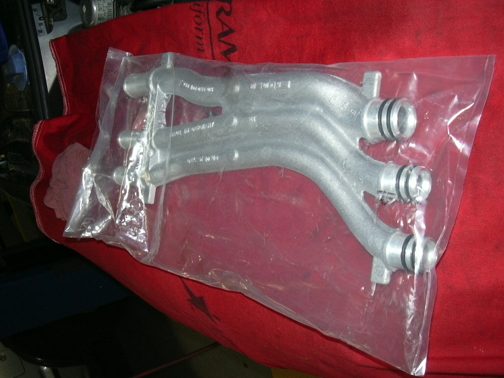

New Cayenne owner but not new to Porsche question. Are the aluminum replacement pipes replacements for the plastic pipes were talking about here? I see them advertised for $500~$600 for the kit. Is that a good price? If they are a replacement for the plastic, seems that for the money going with the aluminum ones, though more expensive, is a better solution? Here is a Ebay ad saying a 17pc kit w/coolant.
http://cgi.ebay.com/ebaymotors/Porsche-Cayenne-Coolant-Pipe-Upgrade-Repair-Kit-V8-S-/250759695357?pt=Motors_Car_Truck_Parts_Accessories&fits=Make%3APorsche%7CModel%3ACayenne&hash=item3a62714bfd
http://cgi.ebay.com/...=item3a62714bfd

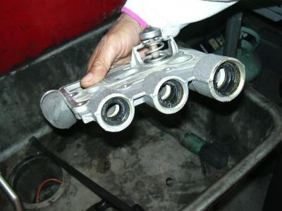

here is the aluminum replacement and location:
post-40009-0-77136000-1298858600_thumb.jpgpost-40009-0-43346900-1298858552_thumb.jpgpost-40009-0-67295600-1298858632_thumb.jpg

So is it my understanding that if you spend the money for the Aluminum tubes you replace the plastic tubes & "T" connector all together? Although if Porsche upgraded to Aluminum replacments then why are they still selling the plastic "T" piece?
thats correct, the plastic T replacement is still the same plastic T and no aluminum upgraded part is available (as far as I know)
