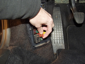

I have a dead battery in my 99 996. The hood is locked, and I have seen the information on how to jump the positive terminal in the fuse box - I have attached a pic of what should be there. However, when I opened my fuse box, I am not seeing a positive terminal in the attached pic. I tripled checked using pics and diagrams, and I had a friend check as well. Is this possible? I have tried searching for the part online as well, and I had no luck. Any help would be appreciated!

You are going to have to use the emergency release cable - the terminal in the fuse box was not added until model year 2001.

Thanks Loren --- I was trying everything I could to not have to remove the wheel panel, as I have never done anything like that before. Do you think it would be possible to get a battery charger that hooked to the cigarette adapter that could give the battery enough charge to open the trunk? Thanks for your help!
