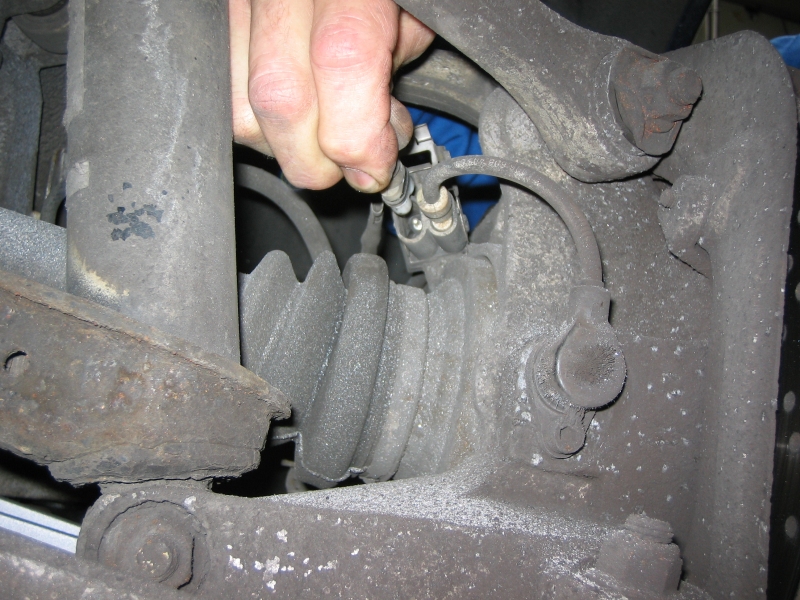

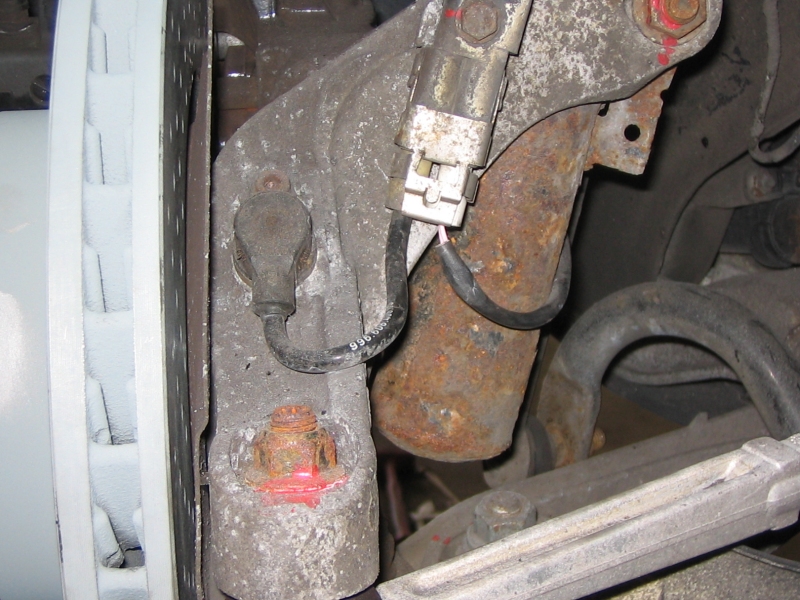

Are you sure you didn't disturb one of the ABS sensors when you disconnected the brake wear sensors? The plugs are next to each other.
Front:

Rear:

100% sure....not. The only thing I did was unplug the pad sensors and tie wrap them without tension away from the suspension and rotors. I will check and make sure the connections are OK. I did change the oil with the car still in the stands. Two of the calipers (the back ones) still don't have the pads because I am still waiting for teh vibration dampers. Accidentally, I touched the brake pedal when I started the engine after the oil change and this is when the ABS light came on. When I plugged the Durametrics, I found all these carzy fault codes including the one for the throtle position sensor. I installede cat bypasses and since then the check engine light has been on. The throtle fault could have been there for a while before the ABS light came on. You think that touching the brake pedal with no pads on 2 calipers could have triggered the speed sensor faults?

Berny and Loren, thanks for your help. I checked all connections and everything is tight. Will ride it for a FEW miles and check again. I already reset the faults.

Anorak, thank you very much for your help and the pics. Turns out that after running the cr everything was fine and the ABS light went off.

Thank you for your help RIchard. The pics were very useful. Problem has been solved
