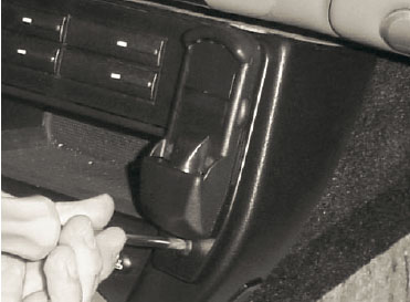

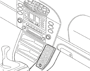

If your install is a flat plate like the item below then you have the cell phone prep. If this is the case then you need to order the docking kit for a specific phone.
If your install looks like this (with docking) then you have the full option - but for what phone?
It's for a 997, so I don't believe those illustrations apply. The 997, has a slot under the number pad that slides out and allows for a SIM card to be popped in.
