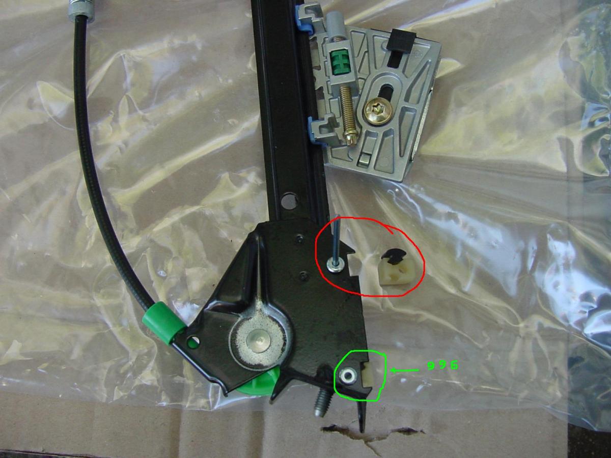

The window regulator part is the same for the 996 and the 986, but there is one difference in the installation which may be causing your window to not go down all the way.
There are two slots for a "bump stop" at the very bottom of the forward leg of the window regulator. The slot that is supposed to be used depends on whether the regulator is being installed in a 996 or a Boxster. Installing it in the wrong one could be the cause of your window now rolling down only 95%.
Here is a photo showing the two slot locations (click on the photo to enlarge). The red circle is the one where the bump stop should be for Boxsters, the green circle is the one for 996's. The bump stop in this photo has not yet been installed. It's sitting just to the right of the Boxster slot, where it it supposed to be installed with the rivet that is awaiting it in the slot.
