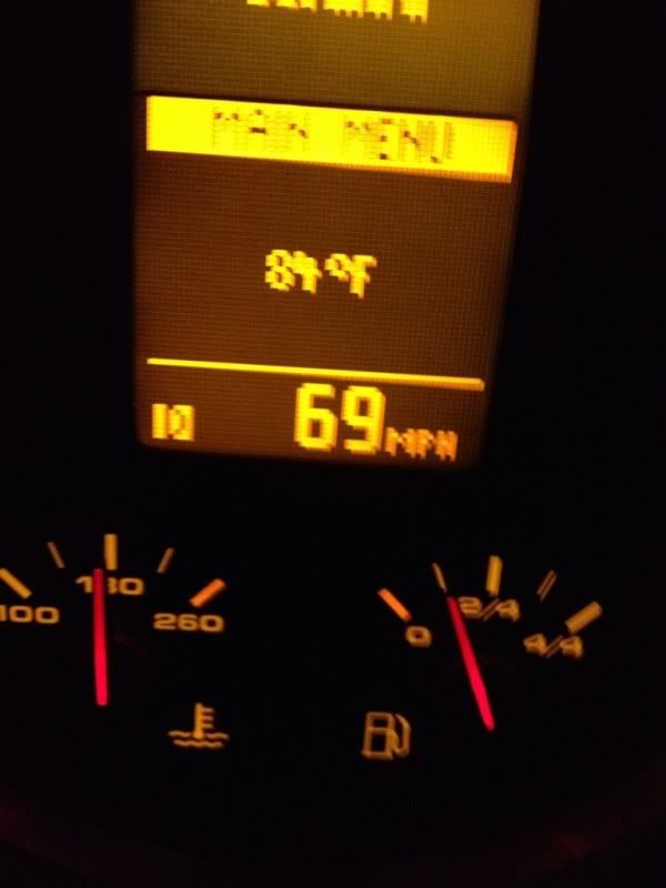

When i start my car up the gear indicator works fine and goes through all of the stages P,N,R,D even shows what gear its on d2 d3 but after a couple of minutes driving it changes to an inverted color D(picture a little block with the d inside) and if i put the car in any other gear including P or manual it dosent change. It only goes back to normal when i restart the car.... Any ideas? This is on a 2008 cayenne S (leaking a little coolant not sure if related)

i had a weak battery but i just got a new onne 3 days ago and the problem is still there. i took a picture of the D im talking about ill uploade it later
there you can see that the D is inverted colors of the regular one, also my durametric says theres a code on my tranny having t do with dme something about test values not finalized. ill verify the code and post it later

The vehicle was just at the dealer last week for a full inspection and no fault codes were reported. This issue just started yesterday. The transmission seems to function properly: i can shift manually, and Sport mode and regular mode seem to work properly, but it never indicates what gear it is in, Just the 'D' in an orange square (just like the picture above).
