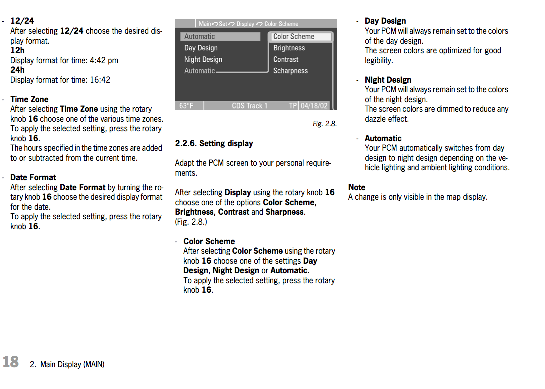

I think deilenberger means the PCM itself has a daylight and nighttime setting -- but this does not impact your vehicle headlight settings in any way.
This, attached, of the setting is from the PCM 2.1 manual. (I have an '04 Cayenne S):

No.. that's not what I meant. I thought that under car settings (using the central screen on the instrument panel) there was an option to enable DLR's. There isn't (went and looked..) My bad. I think this can be set with the DuraMetric pro version, not sure about the enthusiast version. I'm sure the dealer could turn it on with PWIS.
