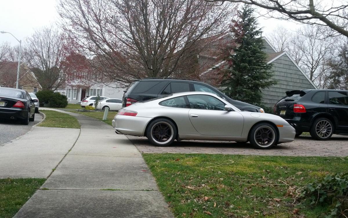

Well I rolled the car to the end of the my driveway which is about as level as it will be without starting it. It is a very slight incline with the nose pointed up. I am aware that this is not ideal but it is the best i can do without starting it. According to the dipstick which I am having a heck of a time reading the car is at the max level without going over. The confusing part is that little I am guessing plug at the top just above the meter, that seems to get covered in oil but the actual meter itself the oil level rises to just before the max indicator. The onboard computer shows the level oil level as at the max level but not over. None of the indicators are blinking as such when it is low. This is with the car sitting with cold ~70 F degree oil.
I am guessing between what was already burnt and the little I did add it is ever so slightly over filled?
Yes, your description sounds right, however pictures are worth a thousand words if you can post some.
