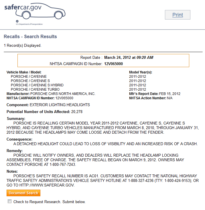

And it was more human error then Porsche engineering: "...it determined some units were not being properly locked into place either at the assembly plant or by dealers."
The headlight housing hardware and locking mechanism work -- it's just that headlight housings need to be installed correctly in the vehicles. I suppose the design and instructions could have had less margin for error (forcing an person to confirm the light housings are properly seated; a safety tether, etc).
Generation 1 and 2 Cayennes (9PA and 9PA1) have a similar mounting and install process -- and we all can read here on this forum that those light housings have to be pressed in and the mount bolt turned until "clunk" is heard.
That said, it's probably somewhat disconcerting to have a headlight fall out while driving.
