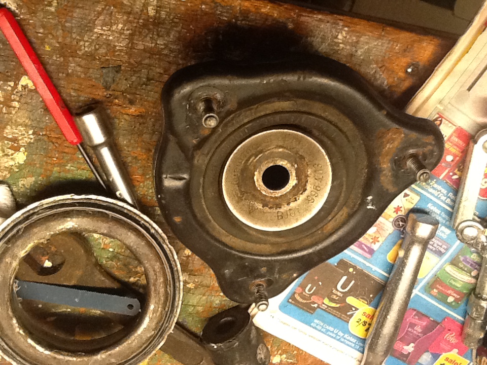

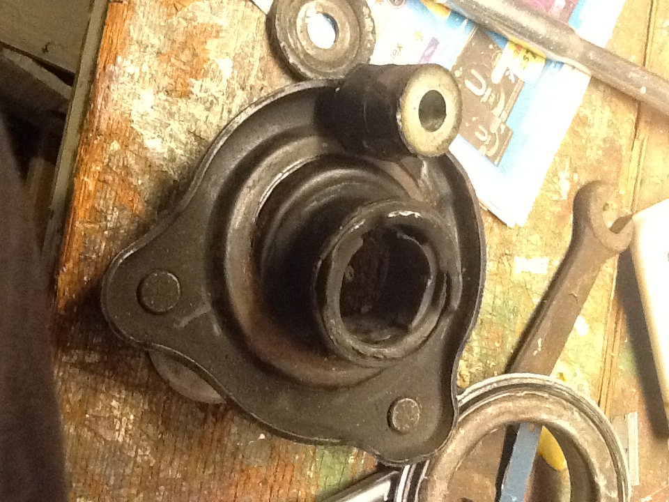

Had some noise in my front suspension and look what I found, the upper strut mounts were shot. If you are re-doing the front suspension in an older car (mine is 12 years old) you might want to replace these too.

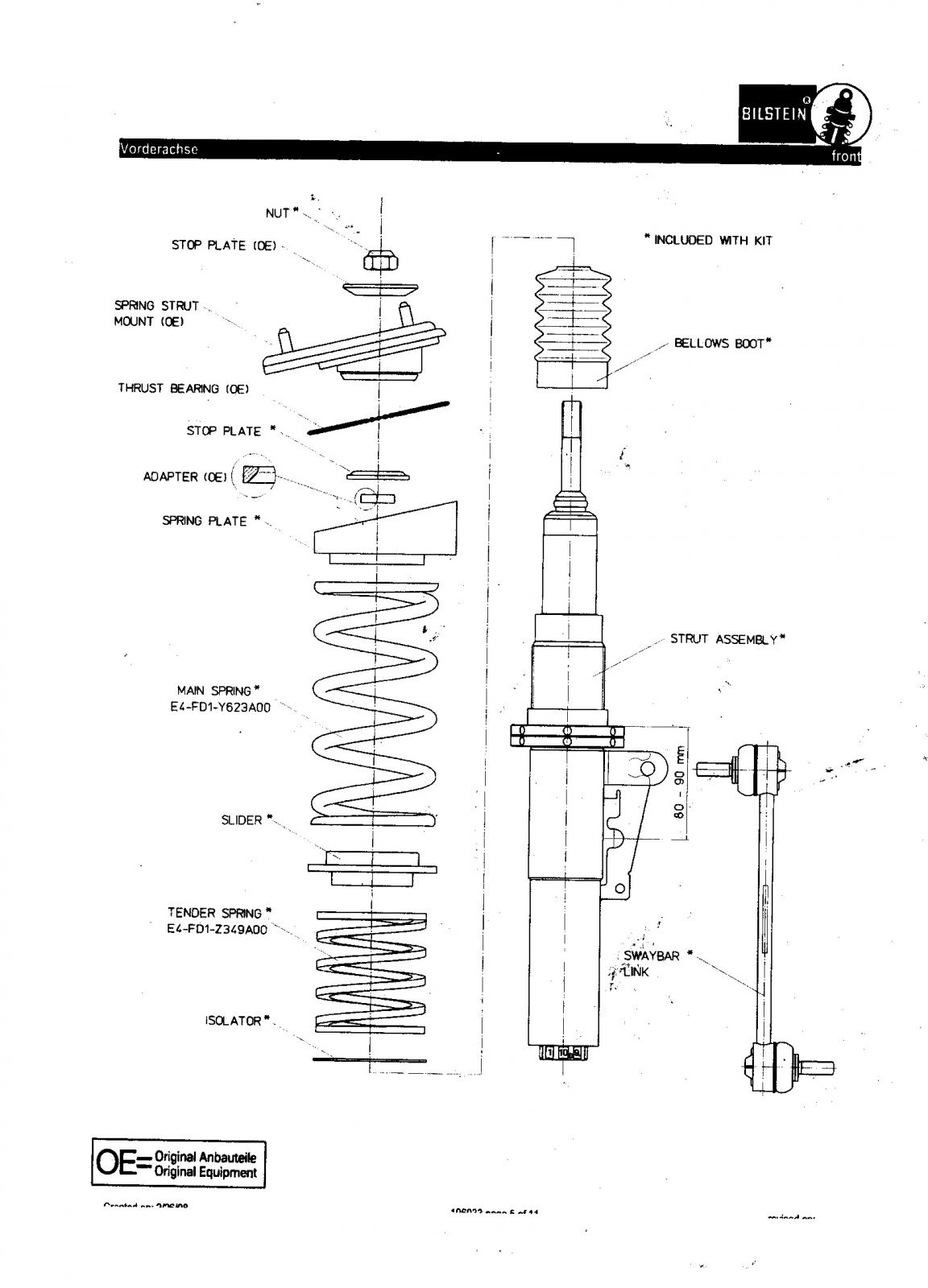

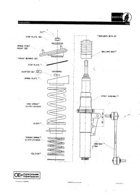

Dharn - is there a way to visually check for this without removing the strut mount...(sorry for the noob question)
I am not sure that you could see the problem without disassembling the strut, I know I did not, but then I wasn't looking for this specific problem. In the diagram of the PSS10 here you can see the two stop plates that pretty much hide the inner part of the bushing

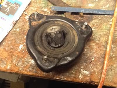

Here are some more pics of the mounts and stop plates themselves
post-7011-0-62066600-1334115263_thumb.jppost-7011-0-05903700-1334115300_thumb.jppost-7011-0-71762400-1334115319_thumb.jp
So with the top nut on the strut tightened the two stop plates compress on the inner part of the bushing shown on the side in the first photo, hiding it and holding it in place. On mine I could not see that the rubber that held the inner piece in place was basically gone. Maybe if I ahd known what was going on I might have been able to tell, but certainly not without removing the strut from the car..
Having thought about this further, if you remove the top nut and stop plate while the strut is in the car you should be able to see the bushing. To do this I think you need to have weight on the wheel, so that the shock portion of the strut does not drop down, and you need to be able tp keep the shaft of the shock from turning, which can be a problem.
