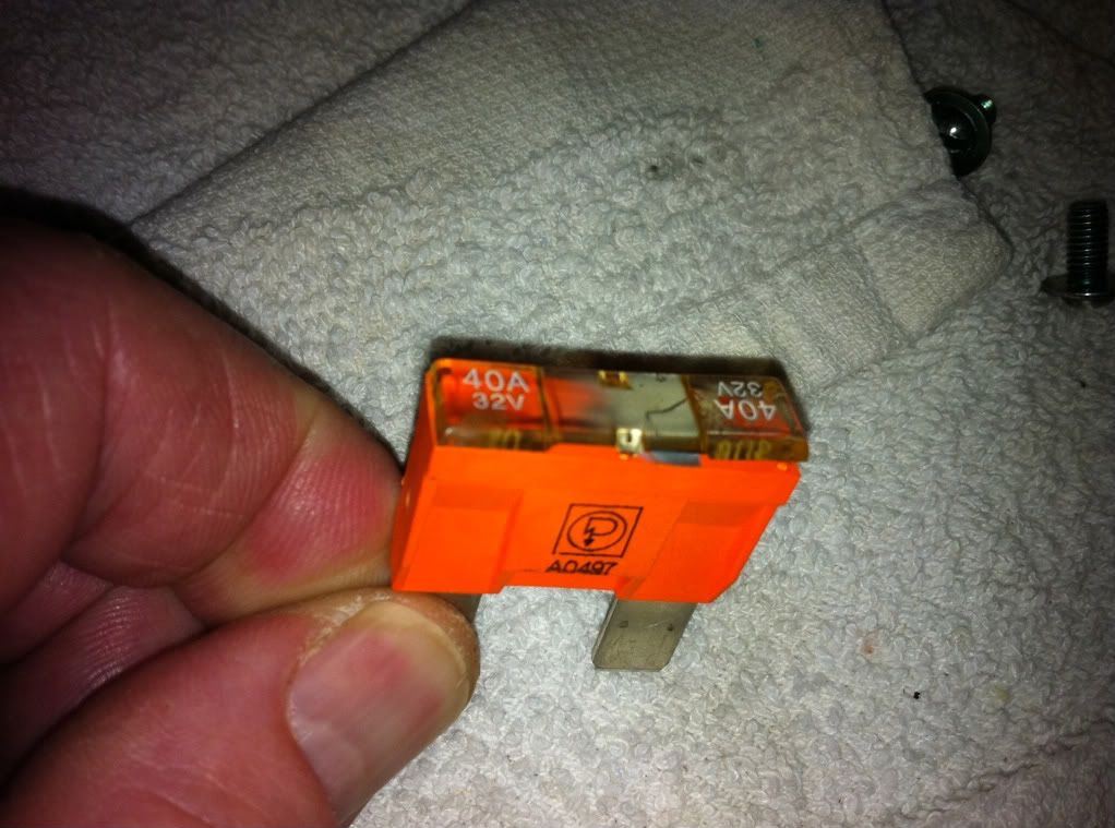

Check the fuse and relay for the secondary air pump that is located on the relay support panel 2 (inside the rear trunk under the carpet).
I suspect the fuse is blown (40A).
Looked at that last night but the light was dim. I was hoping that would be a quick fix. Next would be the relay (position 10 if I'm not mistaken).
The fan noise you heard was probably the engine compartment fan. It's in the same general vicinity as the SAI. To my understanding from observing operation, and reading up in the Bentley repair manual, the SAI only comes on during a cold start.
