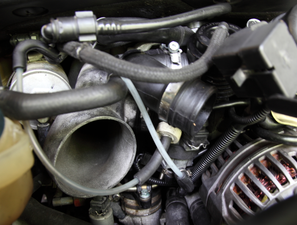

I have finally come to a roadblock - I can't find where the end of the hose goes in the pictures. One end attaches to the valve, and the other end sucks air at the present time. It probably goes behind the whole mess there, but before I try to find a home for it back there I thought I'd check with someone like you that has a memory span more than 10 minutes.

Can you be more specific about the hose. Are you talking about a sense line on the diverter valves? If it is a sense line, page 611 of the repair manual got a good routing of those lines....There is also a routing of the sense line on a sticker under the engine compartment cover.

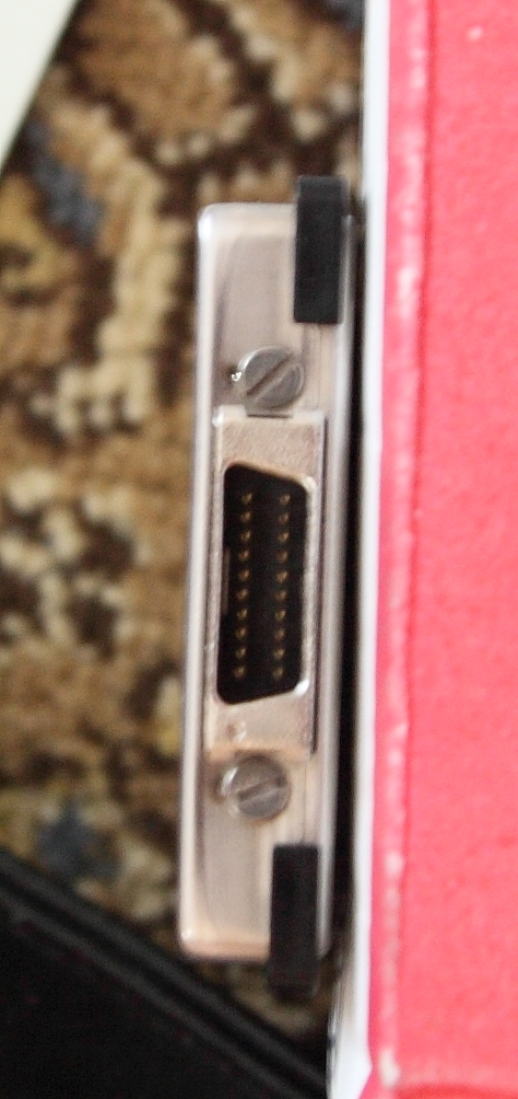

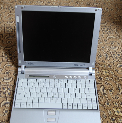

That's what the PST2 I got looks like. Won't get to play with it until the car is running.
Found vacuum line connection - moved 40 wires and hoses and voila! Then it was a whole nother job putting the hose on it.
Your PST2 is exactly like mine, same interface card but I'm on a Dell computer. Have fun with it!!!! Good to know that you've found the sense line connection!

I haven't connected the PST2 to the car yet. I can't find the [<<] or maybe its the [>>] key. The menus look a lot like Durametric's. It says you can log up to 8 variables at a time - how long can you log for? I saw a download on this site for the instruction manual but all I found was 10 pages of warnings about electrical hazards. Have you seen a complete manual or just used the one in the program.
Mike
On a PC keyboard the following are equivilents:
[#] is F9
[arrow with dots] is F10
[<<] is F11
[>>] is F12
There is nothining in the PST2 manual that is vehicle specific. Each section of the corresonding service manual has some explaination to use for that specific task (i.e. alarm)
Loren's got it. The only key you have to use on your laptop are mostly F12 to accept or carry on, to return F11 and sometimes the bottom screen will show you f4 or...I can't remember the other's but some at the bottom like diode test etc. are useless

The PST2 was very easy to use. I'm surprised it doesn't know what vehicle its connected to, but it sure goes at least one step beyond Durametric's
