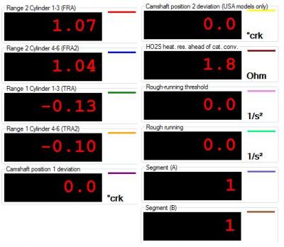

Received my Durametric cable today to clear my airbag code that I generated after disconecting the side airbags by mistake. It cleared all just fine so all good!
Out of interest I also checked Motronic but can't make much out of all the info-values.
Does anybody know if they are looking all right?

post-43071-0-53818200-1352183729_thumb.j
Looks like a mildly driven car. Range 1 indicates the number of ignitions during which the rev limiter was hit (harmless). Range 2 indicates over-rev so 0 is good. Your range 1 happened when the car was relatively new (~9,700 km estimated) since 2548 hour is close to the total number of hrs on the engine (2754 hours).
FRAs and TRAs look normal. You took these numbers when the engine was NOT running? The rough running should be non-zero and fluctuating when engine is running. Also camshaft deviation most likely is not 0.0 but I suppose it could be. For segment A and B, see this thread logray posted. http://forums.rennli...uired-easy.html . Not sure about any conclusion but at least one person has the same segemnet A-B values as you.

Ahsai, thank you for your time and and easy to understand explanation.And you were wright that the engine was not running when I took the read out.
