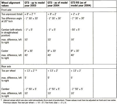

Here are the numbers for the 2004 GT3, for both RoW and USA. Thank you Gert for finding this information.
Front axle height: 115 + 5mm (115 to 120mm)
Rear axle height: 128 + 5mm (128 to 133mm)
Front axle:
Toe unpressed (total): +8' +/- 2'
Toe difference at 20° lock: -1°30' +/- 30'
Camber: -1° +/- 5'
Max camber difference, left/right: 10'
Caster: 8° +/- 30'
Max caster difference, left/right: 40'
Rear axle:
Toe per wheel: +13' +/- 2'
Max toe difference, left/right: 5'
Camber: -1°50' +/- 5'

Updated GT3 (mk1)/GT3 (mk2)/GT3 RS specs:
Height:
911 GT3 M002 = road version and 911 GT3 M003 = Club Sport version are the same as far as adjustment is concerned.
The GT3 - from model year 2004, is also offered in USA. The values listed are valid for RoW and USA.
The GT3 RS (as of model year 2004) is not offered in the USA (August 2003 version).
Alignment:
