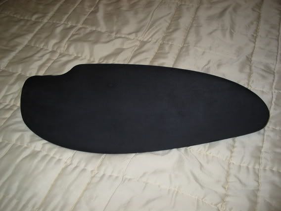

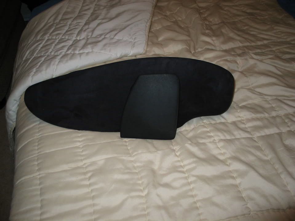

Here's what I did during sunday afternoon - I am going to continue a bit more but this is a good beginning IMO.
Plans are to replace the 80's 'fur' from the lower side of the doors with alcantara and the rest of fake leather bits of the center console as well
Due to my nonexisting skills in photography the console bits seem gray even though they are the same shade of black as the cluster cover.

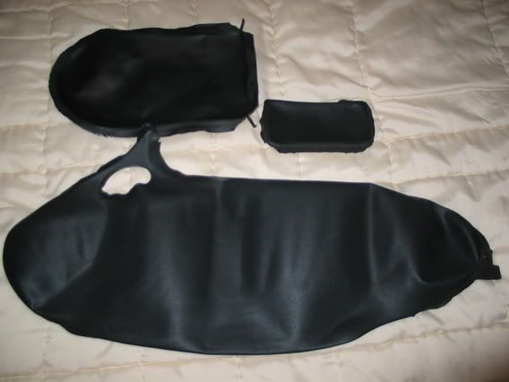

Originals as templates:
Center console:

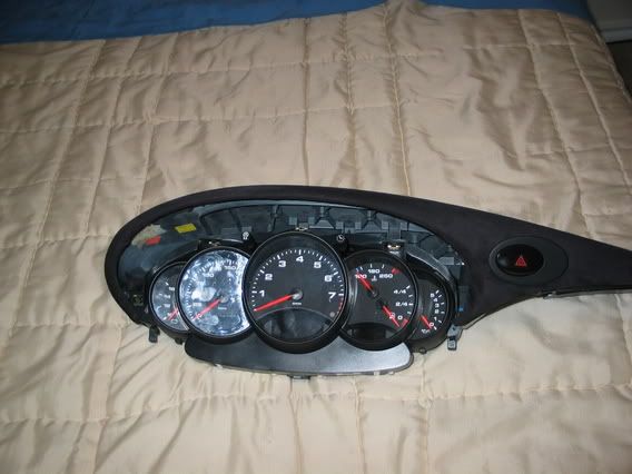

gauge cluste cover (or whatever that's called :) )

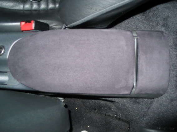

Here's a a pics of the cluster cover and one center console side pod...o.g. ones are a tad lighter but I am fine with that.

What did you use to remove old vinyl since it's bonded to the plastic panel pretty well with foam sandwiched in between? Did you leave the old foam or removed it?

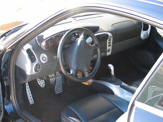

Yes your customization looks great. Did you say that you did the Aluminum look yourself. As in you painted the pieces your self? Cause it looked pretty good. Let me know what paint you used and primer and all that stuff. I will be doing my brake calipers this weekend or the next.. :clapping:

I used a hairdryer to heat up the old material and then carefully / progressively pry it out. I left the old foam in its place, as it should be.
I used PPG paint and clear coat and the color is porsche polar silver. As is in og. alu-look kits I guess?

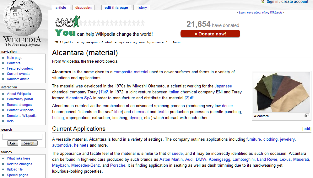

Alcantara is definitely a synthetic. Uses microfiber technology to form the material.
Alcantera is not a synthetic, it is the opposite side of the leather that you usually see. The innards:p!! side.
The innards of leather is suede. Alcantara is a synthetic suede. Probably a lot better idea as it is stain resistant and more stable.
