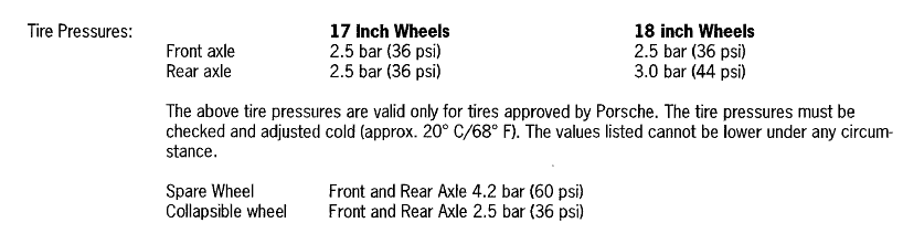

Look under your gas flap.
17" = 36 F & R
18" = 36 F & 44 R

36f/44r psi is porsche stock rec.

Gas Flap...interesting place to put it. Would help if I would pay more attention to things when filling up gas you think! lol Yea my fronts dont look to bad but I may have them do those next time around when I get the rears flipped. Thanks for the confirmation on the psi. I knew I had them right.

I'm running the same size tires that you are on 8"F & 10"R wheels. I believe that the tire pressures of 36F/44R are for a full load and 32F/36R are for a 1/2 load. IIRC, Porsche issued a TSB about tire pressures.
I'm currently running 32F/36R PSI (weekend car) with stock alignment settings and so far find it a good compromise between ride quality and tire wear. I'm keeping a close "eye" on the rears for cupping and camber wear, so far so good. This wil all change soon since I'm in the process of replacing spings, shocks, & front LCA's.
